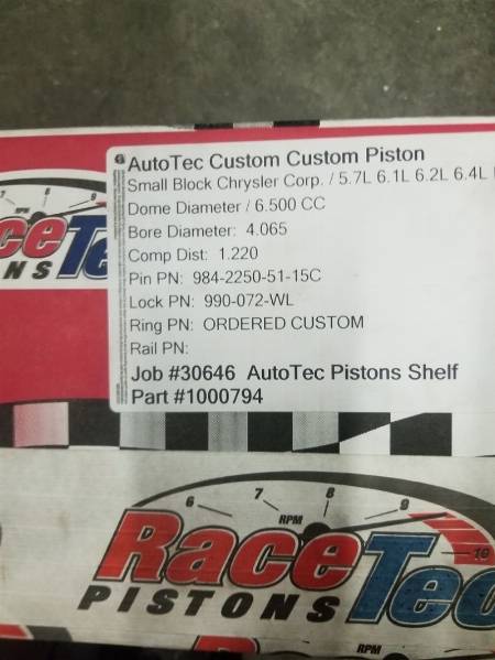

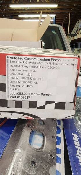

I knew because of damage I was gonna bore it so go big or go home so I ordered a new set of Racetech custom forged pistons and new Manley RODs and had the crank polished.

I custom ordered The Pistons for the Heads and the CAM to its specs this required CC the Heads as I was modifiying the cumbustion chambers on the heads My self.

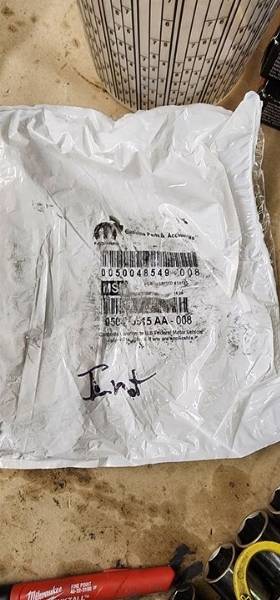

The Eagle heads retaiended the stock size valves although new Stainless steel. new valve springs to match the cam and a new set of special Hell cat lifters. and a custom length Push rods.
The Push rods were the best part as I ordered a set from Chrysler for the Eagle heads, The Push rods worked! BUT One did measure .050 longer from ideal length which did work fine even for engine start up but I did order a custom legth .050 shorter I forget which int or exh? I will have to look if any one is interested ? I used a custom ordered .030 thick Cometic Head gaskets

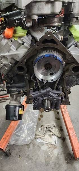

I used the Comp Cam special double roller Timing chain dissapointed with that. Also installed a Melling Pump for it.
