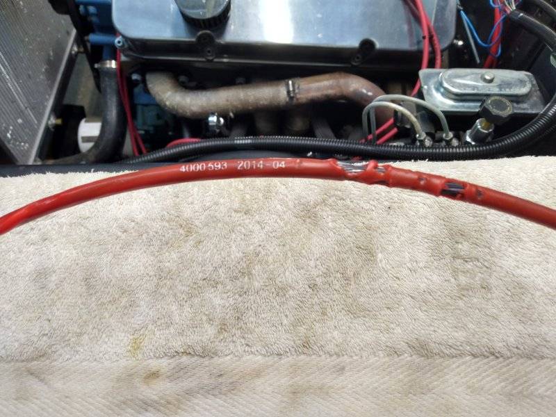

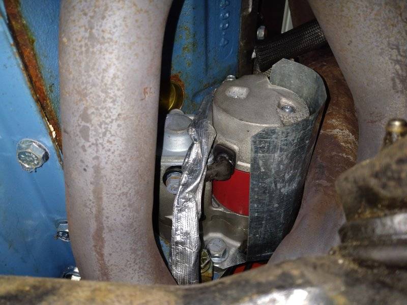

Well, have to order a new shifter cable and some heat shield sleeve before I can see what the idle does when its in gear. I didn't pay close enough attention to routing of the cable and it got too close to one of the header tubes. The outer cover melted and the cable is locked up tight! New spring kit for the mech advance on the way and plug wire brackets so I don't burn one of them.

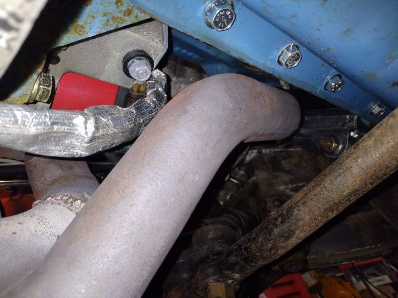

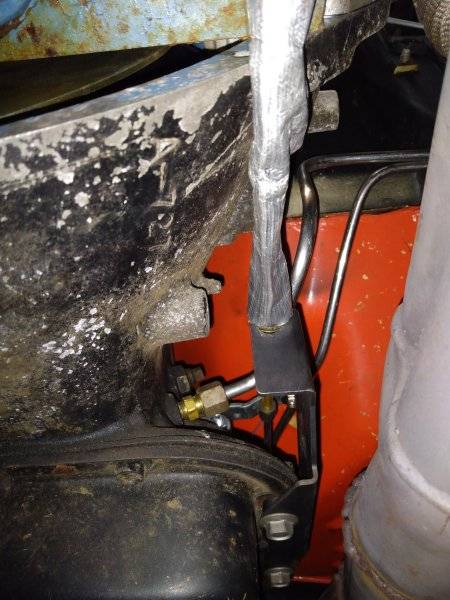

Shifter cable installed, and things move smoothly. Thought I'd throw this question out there before firing things up again. Does it look like enough clearance (min 1" everywhere) between the shifter cable and the header tubes? The cable is inside a heat sleeve that covers from the firewall to the bracket on the trans pan.

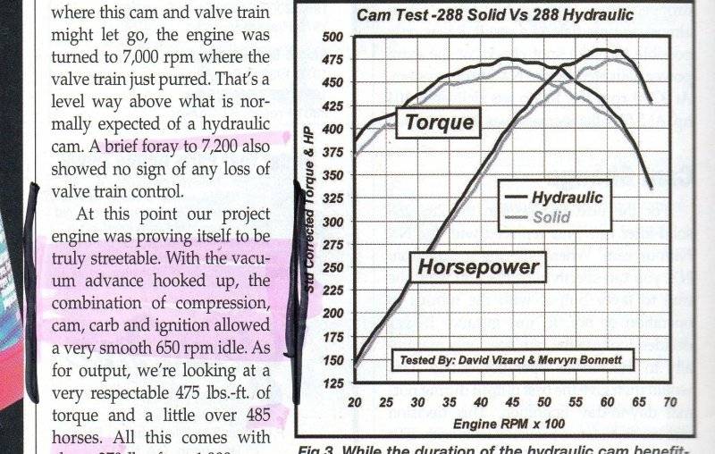

I didn't read anywhere that this is a drag race only car. This is what MVA can do.....
