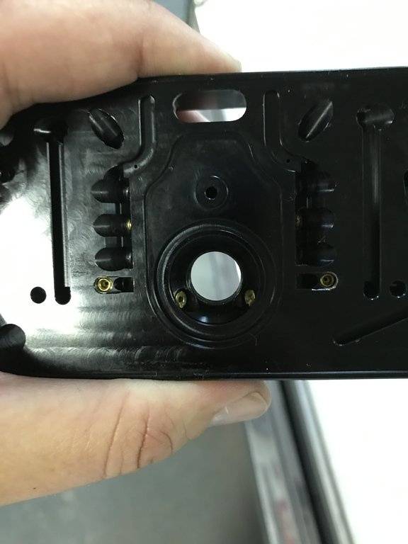

Though If someone can explain to me how the pv system enrichins the idle circuit and bypasses the IFR I will surely listen. I'll even include a picture of a metering block so someone can explain it. By the way this is the metering block that's currently in the rr's center carb. Anyone spot what i've changed since it's out of the box configuration?
This is new info to me as well. Your explanation makes sense but definitely contradicts what I was always taught (but apparently should have questioned). I put the carb back to a 65 last night anyways so I could start back from square one. I'll try again tonight hopefully.
Ya...you moved the idle port to the bottom and added a restrictor.

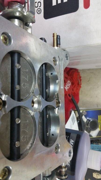

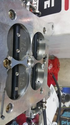

So I spent the night finishing getting things back to a starting baseline. New plugs have been put in without clipped electrodes and gapped at .040 again as I am fairly certain the ignition system is not adding to the issue because I tested all plugs and they are good to over .100 gap with a fat blue spark. I did find that both the primary and secondary side had more transfer slot exposed than should have been. I reset those to my normal starting point (see pictures) and will not change them more than 1/4 turn as I am tuning. I also tore down the distributor again and cleaned up everything so nothing is sticking at all. I had to change the limiter bushing as it seemed to be stickier than I liked at letting the weights return to their 0 advance position. It also looks like there may have been a small vacuum leak at the carb gasket at the base of the pcv nipple so I put a new gasket on. I'll finish putting it back together tomorrow and then warm it up and readjust the valves. Wish me luck.
