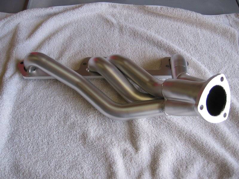

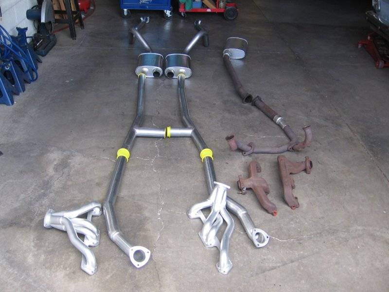

My wife's (my) 65 Belvedere wagon headers
TTI Shorties ! They fit great took a total of 10 minutes to install.
Don't forget the head pipes if not going for a complete system.It will make your life easier.
Yes I also sprung for the head pipes. I already have a new dual exhaust that was done earlier this year. Glad to hear that they are an easy installation. The 360 going in is a mild build. Electronic ignition, aluminum intake and 4 barrel, heavy duty oil pump and a cam for more torque. Plus a double roller timing chain. It should be a good street driver.
To update this thread. I'm installing a 360 and going with TTI shorty headers. Thanks for all the input.

Yeah, I'm going with the TTI shorties. I also have a 440 in a 69 Dart so I am familiar with the hammer modifications. I went with the coated headers just for longevity. Once they are in I'm hoping I don't have to do it again for a long time.
