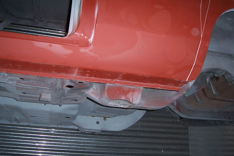

I have a friend that is selling me a rolling shell 1970 roadrunner. It's somewhat stripped, but alot of parts come with it. Somebody started a restoration project and never finished. So, it's a rolling shell for the most part, less motor and trans.
The only reason I'm buying this is because he needs to move it quickly and it's intreguing. When I look under the car, it CLEARLY has a boxed frame, and it's CLEARLY been done at the factory.
Any idea as to what this might be, and if this car has any value?

What do you mean by 'boxed' frame? Do you mean the car has frame connectors? Some of the modern connectors are extremely well made and look like a factory part. I'd like to see pics.
You are likely talking about torque boxes, installed at the factory for 426 and 440/6 barrel cars.
..unless he has not seen a unibody frame before, and is used to seeing a full framed car that uses C-channel steel.
That's my guess without pictures or vin #'s...
Yes, this is basically what I'm describing.
Actually, only ALL ragtops and hemi B-bodies got the torque boxes in '66-70 B-bodies. NO 440 4bbl or 6bbl cars got them, unless it was a ragtop, no Superbirds, no A12s, etc... Maybe you have stumbled upon a '70 hemi RR that was stolen back in the day!
They should look like this...
