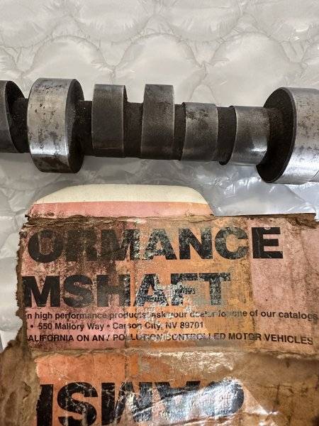

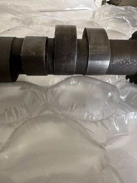

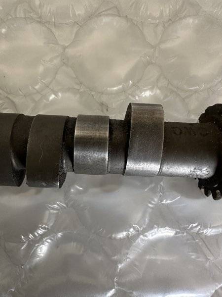

I bought this cam because I was told it’s an NOS piece. Cam doesn’t appear to be used, but no info such as cam card was given.

Is it even a Mopar cam. All the info I can find says Chevy small block.

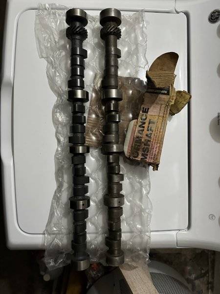

I was skeptical too, but I bought another cam that I’m going to use so I’d know the specs. The right cam is the one for sale, and the left is what’s going in my 440.
Exact measurements between the two, I can't say, but the ramps look a little quicker on the cam you are using.

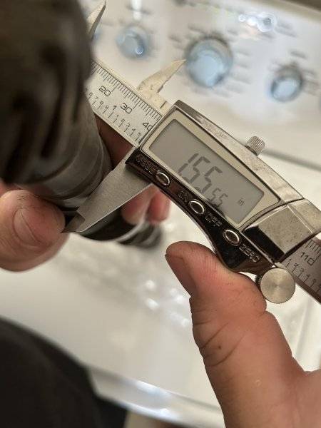

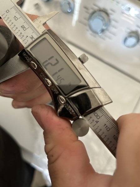

.575 lift? Don't think so... He posted pictures of the base circle dimension and the lobe dimension...
Lobe = 1.5555
Base = 1.2145 Subtract the base from the lobe and you get
Lobe Lift = .341 multiply by the rocker ratio, standard is 1.5 and that gives you
Valve Lift = .5115

1wild, where you are making your error is in ignoring the adv duration. With 320* adv of duration, measuring across the flanks to get the base circle diam will include some of the lash ramp.
The info I gave in post #13 is correct.
The 999XX designation is the grind #, not the part #. It is used in a number of popular engines.
Advertised duration of 320.... On a cam because it runs at half crankshaft speed you have 720 degrees in a full circle. 360 = half a circle, calipers touching opposing sides & looking for the lowest reading should give you the base circle... If you miss a little your only going up one ramp... To add .064 to the lift means you missed the base circle by a bunch....
.064 divided by 1.5 (rocker ratio) gives you .042
Advertised duration 320 and an @.050 duration of 277 so 43 degrees of crankshaft rotation to pick up .044
You have half of 40 degrees from 320 to 360 and half of 43 degrees in the ramp to hit .050
So lets be safe and say it would take about 35 degrees of cam rotation
Not meaning to be a dick but the math doesn't add up...
The maths does add up......if you do it correctly. This is a sol lifter cam, so 320* is at tappet lash.
Closest example I could find with actual numbers is an Isky 550. 330 * adv duration, 279 @ 050, 0.538" valve lift.
Yes, 720* of rotation. So half [ where you are measuring for base circle is 360* ]. This Isky cam @ 361* has 0.012" lobe lift, 321* @ 0.020" lobe lift. And this is just one side, you have to multiply by two.
As I said in the earlier post, with big cams you CANNOT measure across the lobe for the BC with long duration cams as a means of verifying lift.
