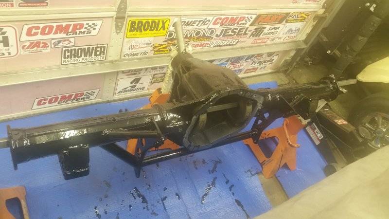

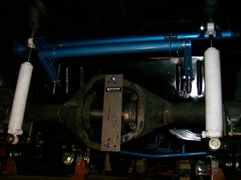

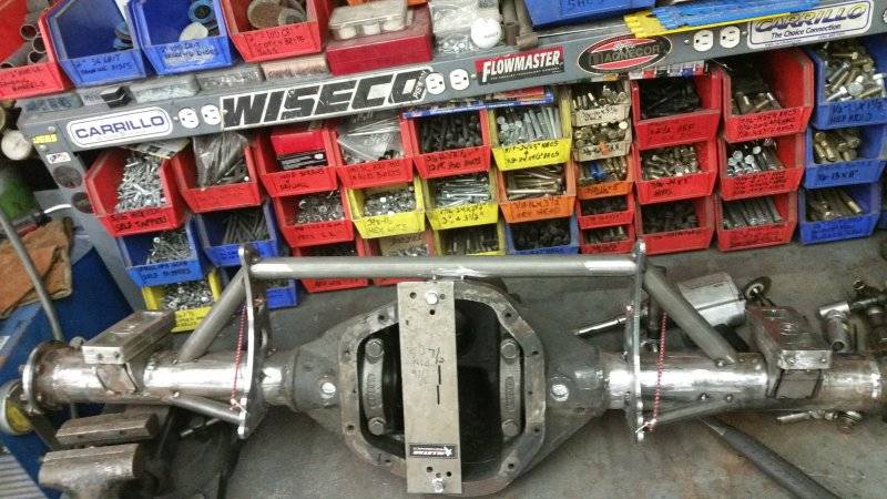

I narrowed a 1 to Dodge truck axle for my Challenger. It is the thick wall thickness also. If I remember correctly it is 1/2" wall. Yes, I used the standard Chrysler off set when narrowing it to aligned with the rest of the drivetrain. I cut the full floating truck ends off, narrowed as needed, welded on the Strange Engineering Car ends.
