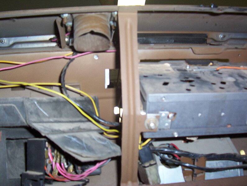

I am putting my dash wires back in. Everything looks like it has a place.
I can't remember what to do with the under dash relay (for Horn?) and the key buzzer.
They have captured nuts on them so they must get screwed to something. I am looking for the factory location and mounting technique for these for a 1970 coronet. The buzzer is near the fuse box and the relay is near the light switch.

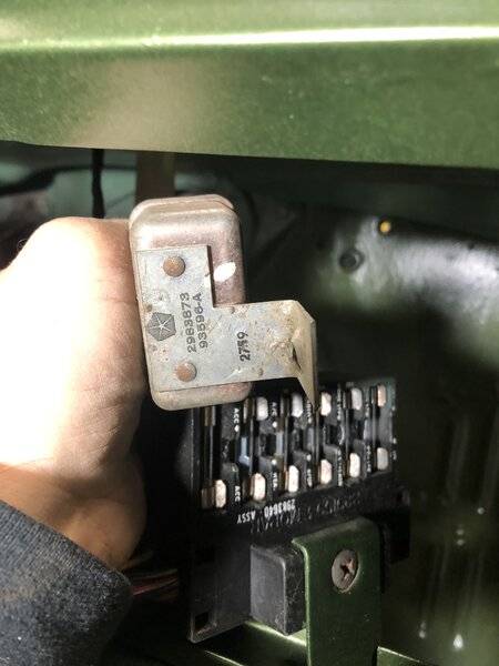

On my 69 Charger you can see the one by the fuse block. A screw goes straight up from the bottom of the dash to the relay.

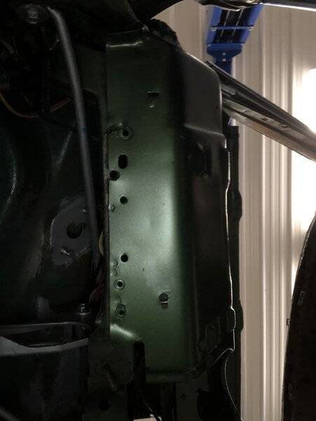

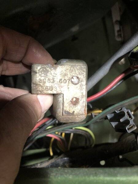

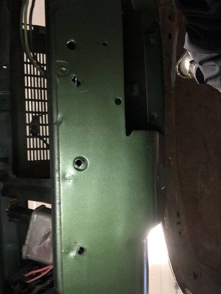

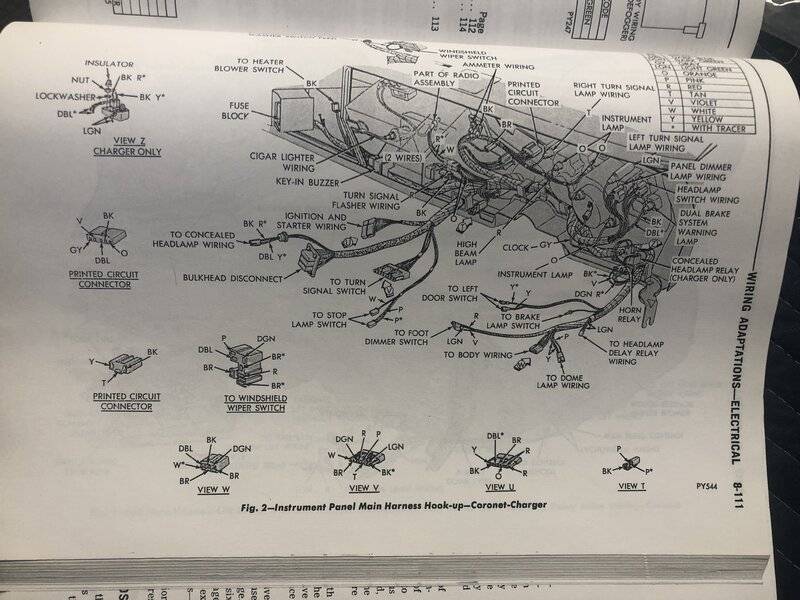

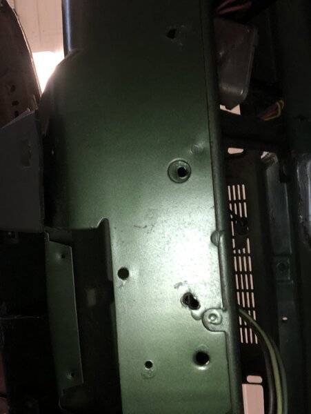

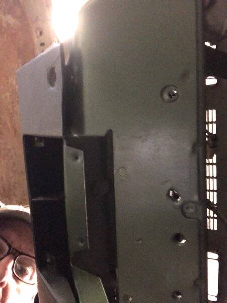

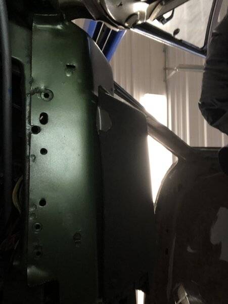

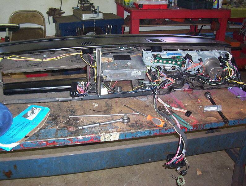

Thanks for the pic. Here is the dash diagram from the manual and pics of my lower dash. It just doesn’t show which hole to use. Anyone pinpoint which hole?
3904A407-C88E-4F48-852C-B0ECFB10C165.jpeg 779C487B-E6B8-4452-92A4-AC4ED091AEA8.jpeg

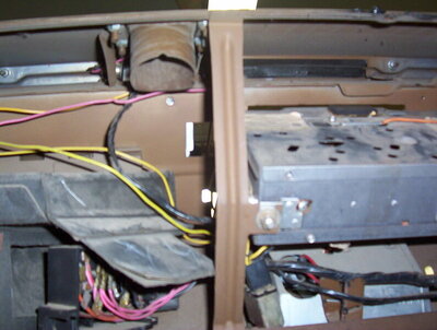

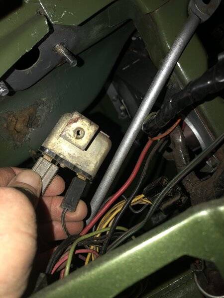

I found this when I took the car apart. You can see the dash brace and wire orientation. So setting yours in that place as shown should get you over the hole you need.

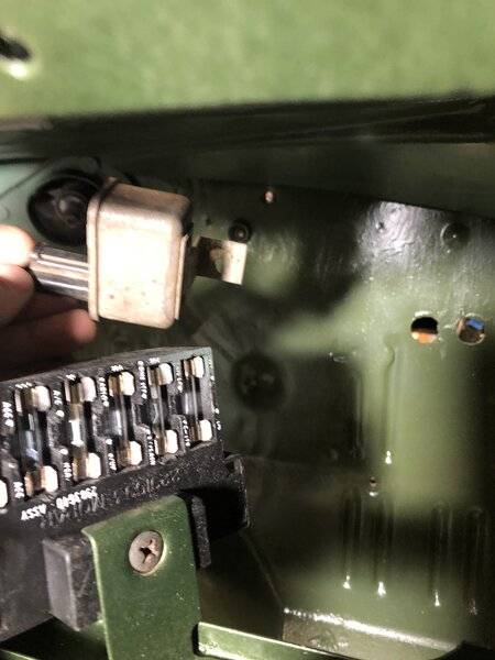

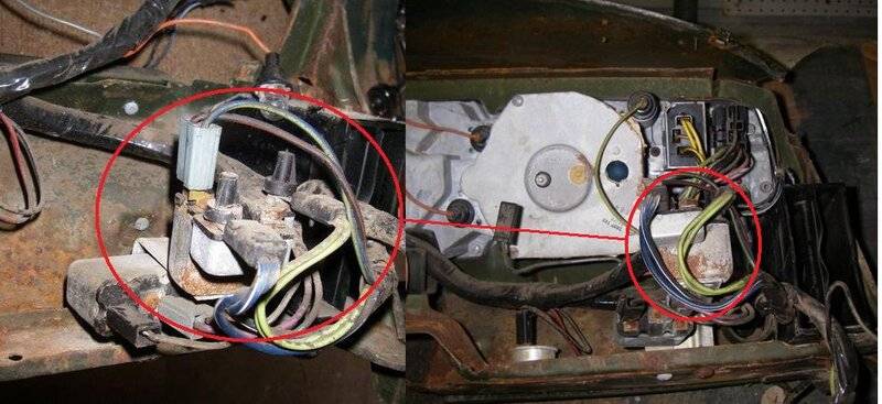

horn relay on 70 Charger, right underneath the headlight doors relay ( Circled ). so you could catch which hole for relay thinking on that
