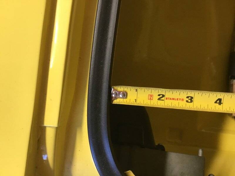

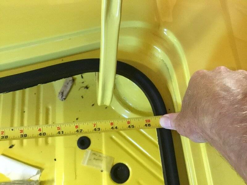

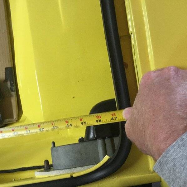

I can check my original tonight if nobody replies beforehand.
I hope this helps
