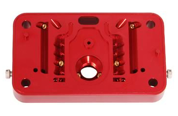

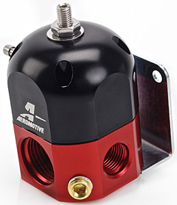

There is nothing wrong with a 383ci except it's smaller cubic inch displacement, compared to the 440ci... You need to learn "how to tune" & diagnose problems with either set up... Get a MP Chrome for street/strip or Super Gold "race only box" for at the track, keep the Orange box for a back up or spare for on the street, if that's your preferences, You absolutely need to have the properly set up valve springs & push rod lengths & valve-train geometry, to match your camshaft... It maybe even a Carburetor tuning &/or fuel or delivery problem, some or most mechanical fuel pumps are just crap for over 5000rpm, I suggest an electric pump with a fuel regulator preferably a bypass style, with a good cleanable fuel filter before the pump & before the carburetor, wire all the fuel pump system with a relay to keep voltage constant & from spiking... I would also check make sure the wiring is all good & you have adequate grounds everywhere {run a 8ga.-10ga. ground wire directly from the block to the ECU}, also the 906 open chamber heads are 10cc+ or so larger combustion chamber, dropping the static compression, if you don't have the proper piston & head gaskets combination, to compensate for the larger 88cc-90cc combustion chambers... What do your plugs look like ??, what does the dist. cap look like ??, is there any black or orangish crusty stuff in there ??, you could have a cracked cap or something simple like bad wires, fouled/bad plugs, rotor, cap, reluctor air gap should be 0.008"-0.010" {make sure to use a non-magnetic bronze or brass type feeler gauge}, bad pick up or coil, etc... how long since you changed the plugs, wires, rotor & cap ?? Good luck & happy Moparing...
