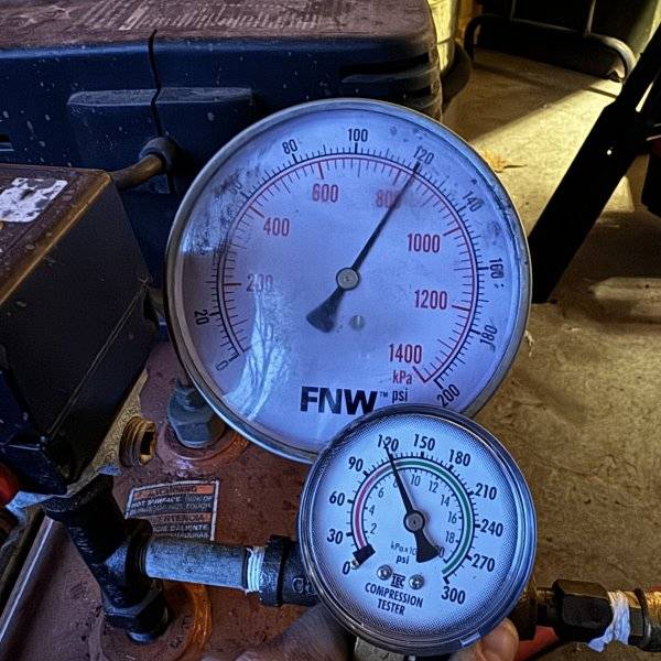

To the OP, are you sure you are reading the gauge correctly. And did you do all eight cylinders? Maybe take a picture of the gauge after you've done a test and post it. If you actually have 170 psi, you would have audible detonation any time you leaned on the throttle going down the road.

I have the motor completely disassembled in my garage right now. I did a compression test on all cylinders and these are the results…
8-160
6-40
4-120
2-120
1-150
3-90
5-150
7-170
Cyl6 had missing pushrod
Cyl3 had very sunken exhaust valve
