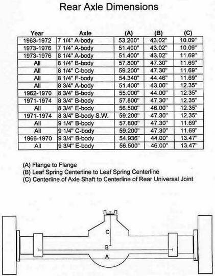

I was thinking of upgrading to a 8 3/4 rear for a 70 charger and i have found a housing at a descent price my only concern is the measurements, ive seen a lot of charts that say 54 15/16 flange to flange but he says it originaly came out of a 68 charger but the measurement is 55.25 is this right or would it fit ? He says it has 44 inch perches and drum to drum it measures 60 1/8 and if you take 2.5 inches away on each side for brakes you get 55.25. Can anyone shed some light for me on this before i buy this. Thanks.

My guess is this guy's measurements are just a little off. Looking at this chart, and assuming it hasn't been narrowed or something OR out of a pickup truck/van (did they do that?), it sounds like the correct rear end for your 70. I can totally imagine a tape measure being 1/4" or so off, especially trying to measure around the center section. I don't think you'd be off by 2" or so.

You have the right housing. The data I have for 68 to 70 drum to drum width is 60 1/8. You can't just subtract the brake distance from the drum to drum measurement with out considering drum flange thickness and backing plate thickness. If you factor all that in, it comes out pretty darn close. The 44 inch measurement is correct, as noted by wyrmrider

The chart above is misleading at best and inaccurate at worst. All 62 to 70 B bodies had 44 inch perch centers. The 8 1/4 B body rear end listed in the chart is for 71 and up. The overall width varied from 62 to70, regardless of what that chart says.
