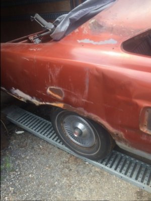

Trying to decide what mig welder to purchase for my 70 Roadrunner project. Looks like I'll be doing mostly sheet metal work. However I do need to replace part of my rear frame rails due to rust. Right now I'm leaning towards the Hobart 140 since I don't have 240 out in the garage. Any advice is appreciated.
