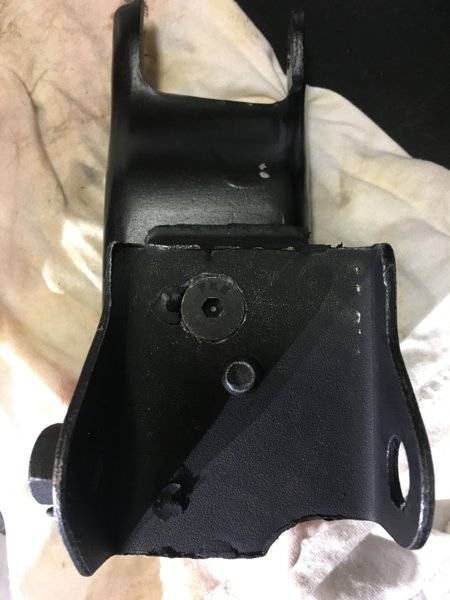

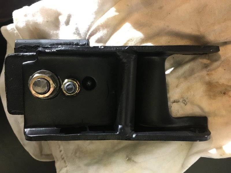

Whatever you do, DO NOT only use stock engine mounts, especially the new Chinese crap mounts. Do either Torque strap, Schumacher mounts, or solid.
Drivers side
So far so good on my 383/432 Stroker
8A56F0D6-9EDB-4A14-9EEB-B609843B8E42.jpeg 5A0F0B8F-1593-47FA-BC0D-0FEB486F7E01.jpeg
My 440 is happy with the 850 Demon. Using Schumaker Interlockers for mounts.
My driver side mount has two bolts through it like the one posted above, zero issues and doesn't cost a fortune like the other mounts.
