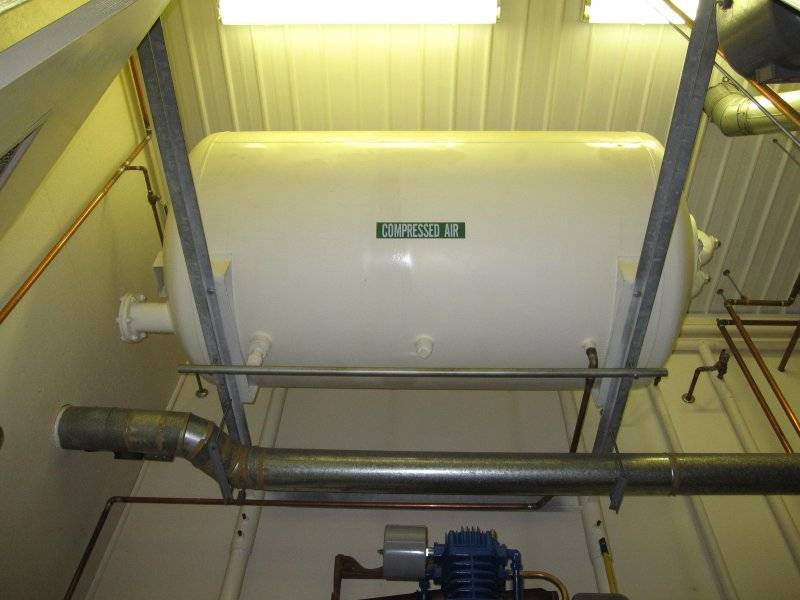

I second the recommendation of more storage. Look for dead compressors with good tanks and several can be plumbed together for extra volume. I fell into a nice little 500 gallon tank for my shop!

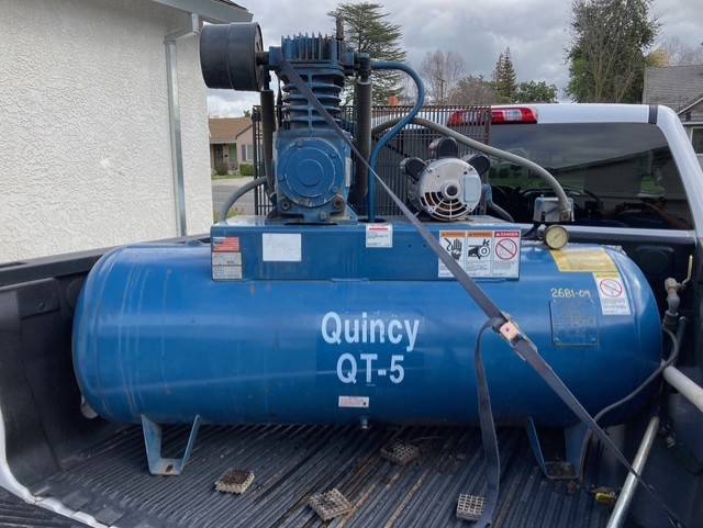

For sure you want a 2 stage. My 30 year old Quincy QT-5 is 175 psi at 17.5 cfm. No problems with keeping up with blast cabinet.

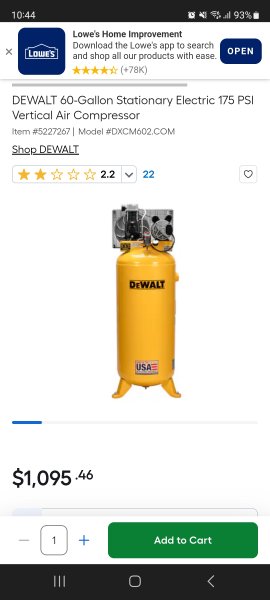

Having said all of that my interest would be +/- 1k, possibly more but I am not looking for nor do I feel I need a 2k compressor. I have been looking at mostly 60 gallon, single stage, with 11.5 cfm at 90psi. I would prefer more, but again, occasional use. I have considered a DeWalt with the 5 hp, 60 gallon and I think around 15 or so cfm @90. Somewhere plus or minus $1300.
