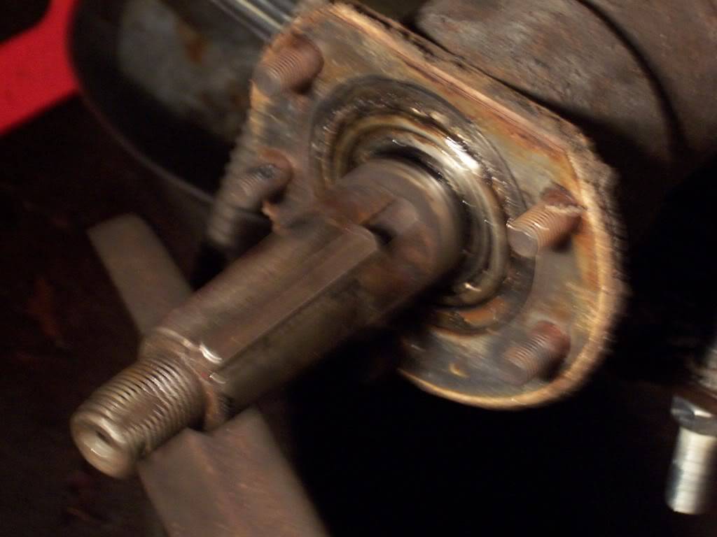

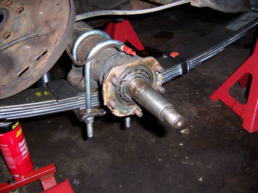

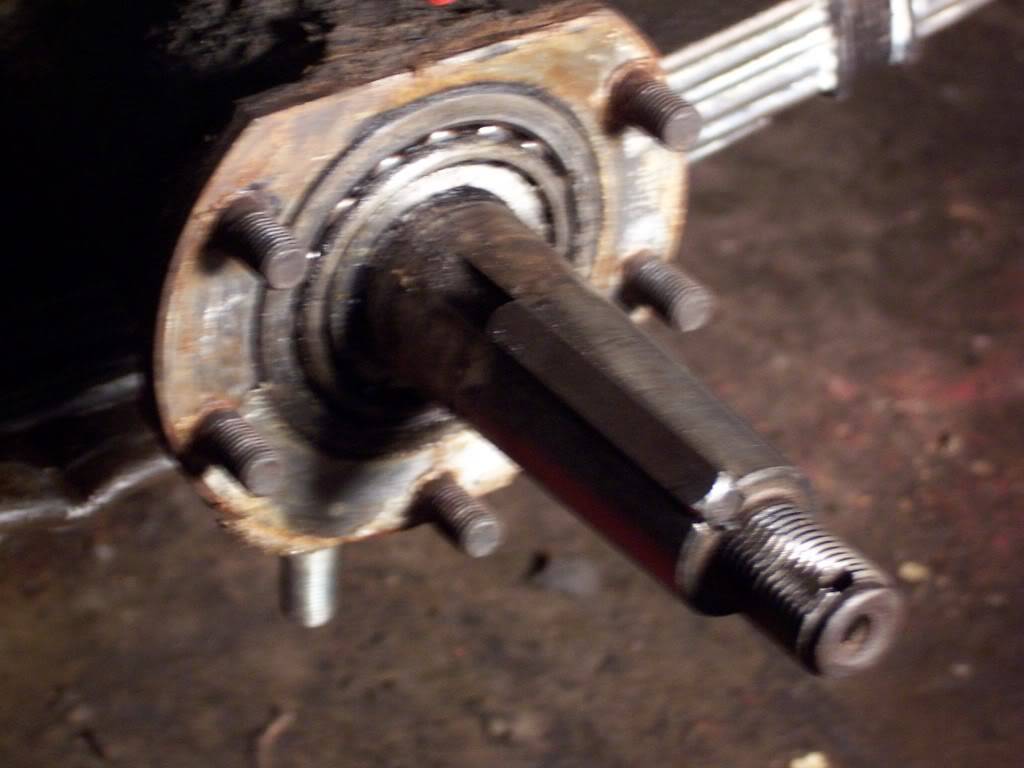

Here's some pics of the axle/housing ends;first 2 pics are the passenger side,and the third is the driver's side. Opinions/comments/suggestions?
Well,I want the car on the road this year;I've already found a couple of major setbacks,and as it has gone "legal":(,can't say much more. Finding a 65 housing would be difficult;time to hit CL... I thought 66-7 had wider spring perches than 62-5? Need to check that;there's a rough 66 dodge not that far from me that could donate some parts. Been checking Ebay,going to hit a couple of specialty tool places;I'll let you know what transpires.

I asked the guy that helped me do mine , he said he has a slide hammer that attached to the axle threads . Pretty simple tool to make , just a rod with a hole drilled and tapped for the axle threads and a bolt on the other end to stop the weight . The shims are behind the plate with the five holes .
Any 68-69 b body axle will bolt right in, perches are the same distance...44 inch on center, but if memory serves, it is wider overall, so some back spacing measurements will be in order if you plan on doing a set of custom rims to get the widest tire possible to fit.
