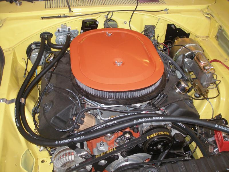

You can get a complete set-up as I did or go to a Salvage yard and get your components.
1. You will need a Power Booster
2. New (salvage yard or New) front spindles
3. The disc brake set-up consisting of discs, calipers, pads, brake lines
4. Proportioning valve
I bought the MP set-up (Master Power Brakes Kit)
It is just Okay, some manufacturing flaws that I had to remedy.
It uses a GM Booster (YUCK)
