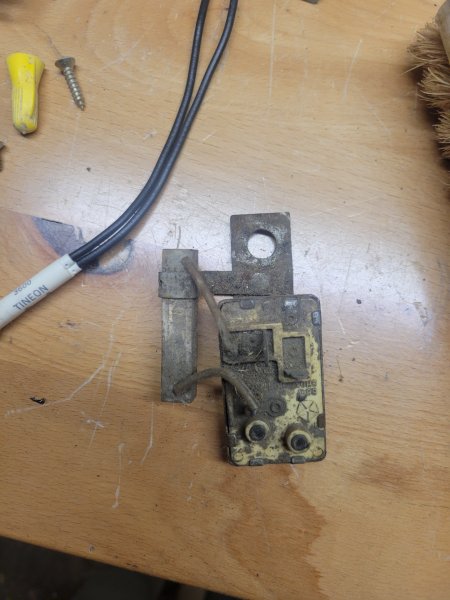

Probably one of 2 things, the heat riser valve, if it has one, in the right exhaust manifold is stuck, or inoperable for some reason, try lubing it with a penetrant like pb blaster or mopar penetrant/heat riser solvent. What you are calling a sensor is actually a heating coil down in the choke well. Apply 12 volts to it and make sure it heats up. There should also be a white choke control module to the rear of the carb on the right side that could be bad.
You may also have a different style heat control that isround. Either way it should have 12 volts in and 12 volts out cold. I would not mess with the carb until you know everything g is getting hot at the choke well.
I hadn't heard of the heat riser problem before, so I'll definitely look into that one. Same goes for the choke control module. But as for the "sensor" what am I looking for in terms of heat? Do I need to measure how hot it's getting, or just make sure that it's at least doing something?
Thanks for the tips. I'm going to get to work later today and see what I can find out.
It gets real hot real fast, not something to hold in your hands. It is a heating element not a sensor looks like a beverage heater.
