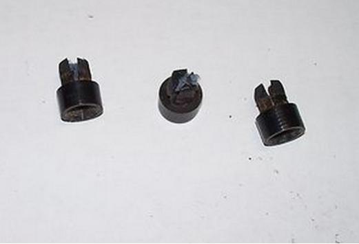

These are the center speaker anchors that you screw the speaker plate to. For 71-74 dash. 0.jpg
i have never seen ones like that.are they threaded inside?either way you should be able to use a blind rivet,or a nut insert rivet if threaded.
Also look like 66 coronet hedalight surround fasteners, If mark doesn
't have them . Try RT Specialities
Well I have some but are sun baked and just break trying to get them off. Kinda figured beings where I live. Just something I did noticed, 71/2 have 4 prongs and are black. 73/4 have 2 prongs and are white.
I guessing these don't come back on the recovered dash pad?
Aveco makes a stance (Part # 16583) that is longer but can be cut down, its only a two prong, but the diameter of the plug and barrel are correct. If you pm me, I have a bunch of extras and can send you some for your dash.
