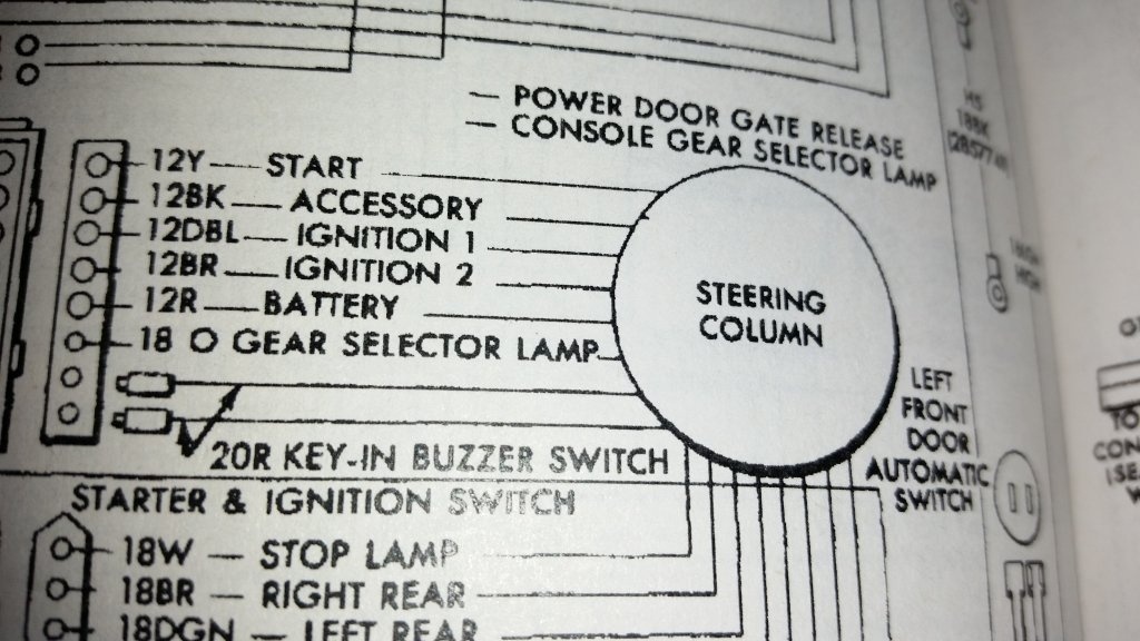

I took a pic of my wiring diagram am I to splice into ignition 1 or 2 ?

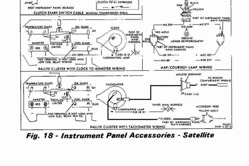

Factory tachs, on '71-74 B-bodies, were connected to the ACC circuit, yellow molded three-way connector, dash harness, near radio. As for the aftermarket description, IGN 1 is the correct answer.
