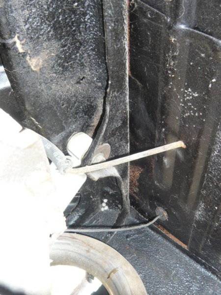

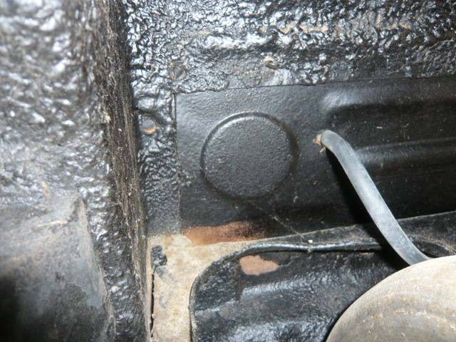

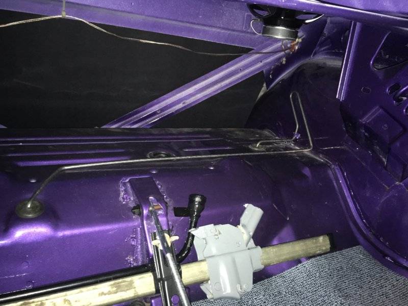

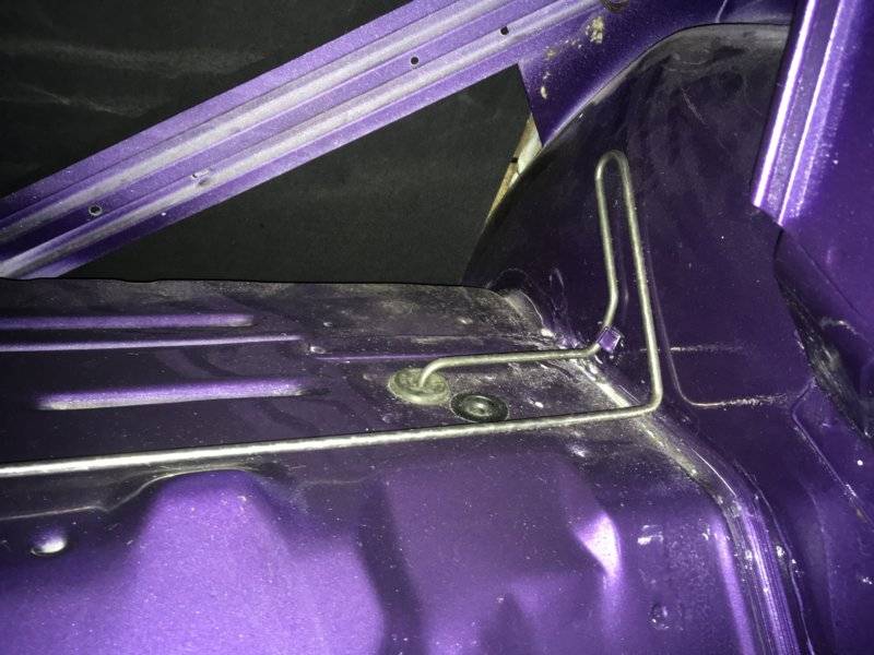

bought the car and pan was replaced and vapor line is jacked. need some close up pics for holes. These holes are wrong. 1st pic passenger side trunk I think the hole gos on other side of circle. 2nd pic under car. Does both vent lines on tank get hooked up? any pic please

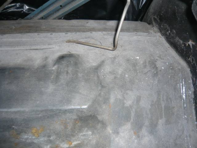

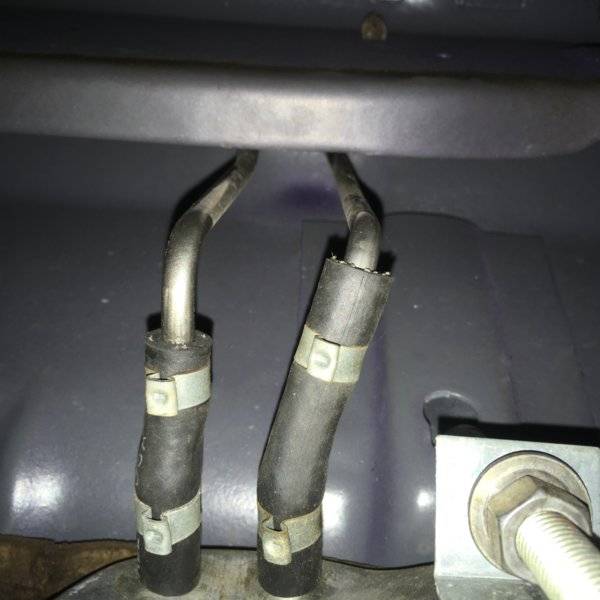

this is the driver side next to the 2 vent tubes
I’ll go take some pics in a bit.

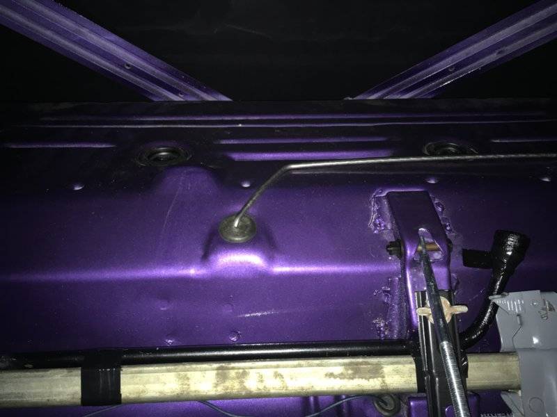

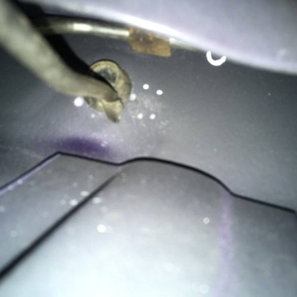

Under car vent line on passenger side just goes up to floor and turns down. (Hard to get a pic of).
The one on drivers side goes up through into trunk and back down into frame.
Hope this helps.
thank you that helps alot. 2nd vent just gos up above the cross member of the trunk.

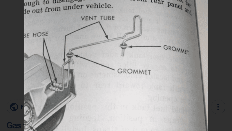

Here’s a better picture
