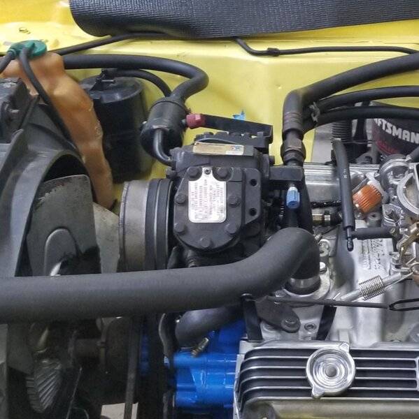

I have a 73 340 Road Runner that came from the factory with A/C. I believe, but am not 100% sure, that this is the original A/C compressor. The decal on the top is a conversion decal (I converted it to R134a).
This metal plate is on the compressor. Underhood of the car is not accessible right now or I'd try to get you a better picture.
Hope this helps.
Hope this helps.
What’s the build date on your roadrunner?

Awesome the little tag was the more important question I needed answered. Does anyone know if the EGR valve and the chrome heater are painted with the intake or not originally?
