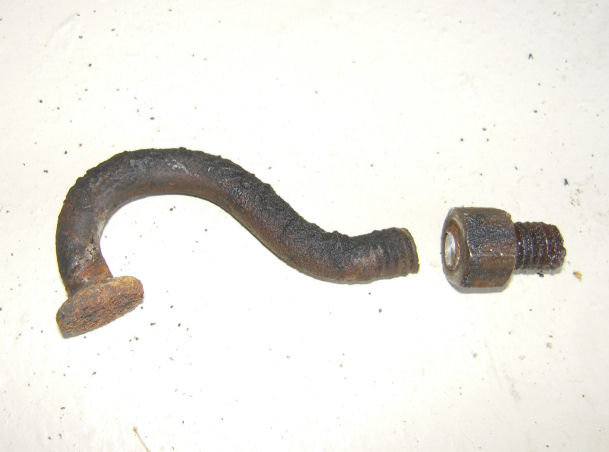

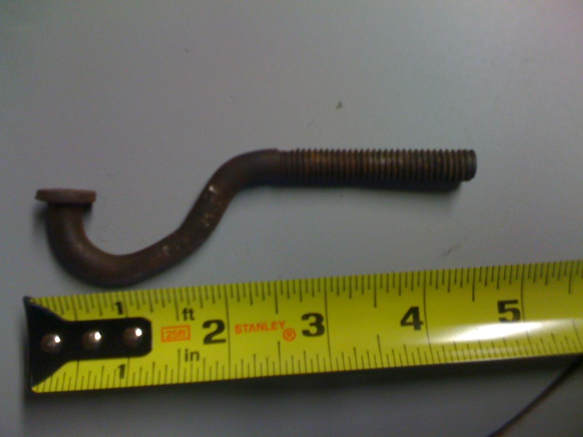

Fuel tank strap stud. NOS #2660872
I see straight ones listed on EVERY site, but they look nothing like what I took off the car.
Has anybody seen this available anywhere?

how about making one w/ a bolt and a torch?
Yeah, it's looking that way. Or a 3/8 eye bolt opened up like suggested in the thread linked above.
I figured if I could find one, I'd order it. Waiting on other parts anyways.

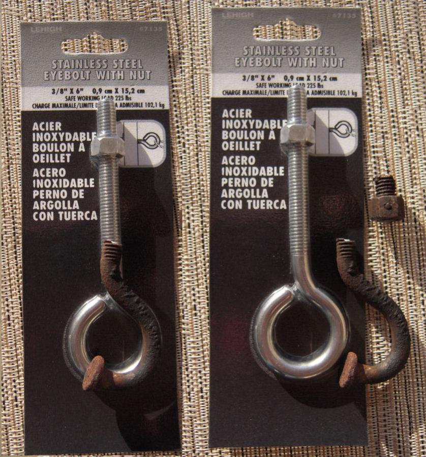

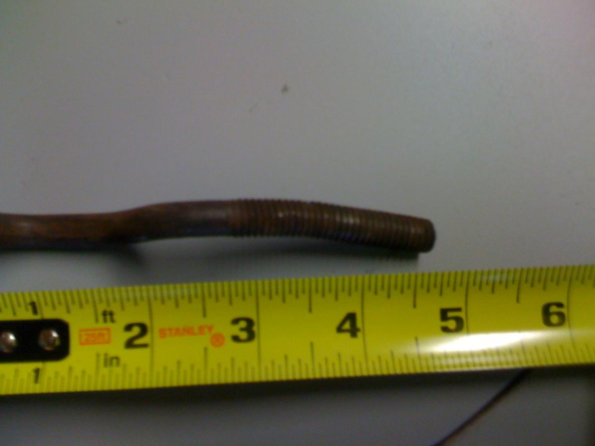

Hey tig, here are the pictures
I had the same problem finding a new J-bolt last summer. I never found anyone that repops the 66-67 b-body j-bolt. I finally had to go to a junkyard and carefully remove one.
I'm just going to make a new one from a bolt. That way I know it's strength.
I've got a 67 out back that I'm parting out. Tank is still in it but it shouldn't be too hard to make one. How bout one made from Stainless Steel?
with a handle like tig welder why not weld a piece of a 3/8 bolt on there and run a die down it to thread the welded splice.
I'll find a bolt that's partially threaded, bend it and then cut off the bolt head and Tig weld a heavy washer or two to the end.

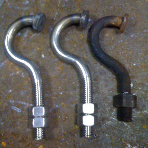

How to make a '66 gas tank strap hook ( fuel tank strap stud )
As suggested in one of the threads I read, I went looking for an eye bolt and found the perfect candidate. Size of eye was almost perfect.
Parts from Home Depot:
Lehigh Brand - Part #7135 - 3/8" Stainless Steel Eyebolt with Nut
(3) 1/4" SS Flat Washers
(1) 3/8" SS Nut ( to lock with other nut )
-Trimmed eye to correct length for hook area.
-Welded (3) 1/4" SS washers on end filling inside with weld
-Then bent the section between hook and threads slightly. In the one photo you can see which way it needs to bend to look like the original part
- You may want to wait until after install to trim to length. Even making it a little longer..it was still tough go get going
Edit: Eyebolt only around $3.30
