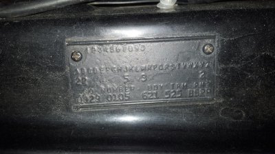

anyone decode this for me please?
Looks like 63 dodge 440 standard engine auto vinyl / cloth interior black with red interior and sweep. Need vin to be sure at what plant.
Here's three of them.
A-2 Code 352 Torqueflight
J-5 Code 385 Heater, Front with Defroster
Y-2 Code 652 Sold car / Expedite
Q and R are engine code, no code = standard engine
Thanks mate, what size was the standard engine? 318 or 361? or 6cyl
