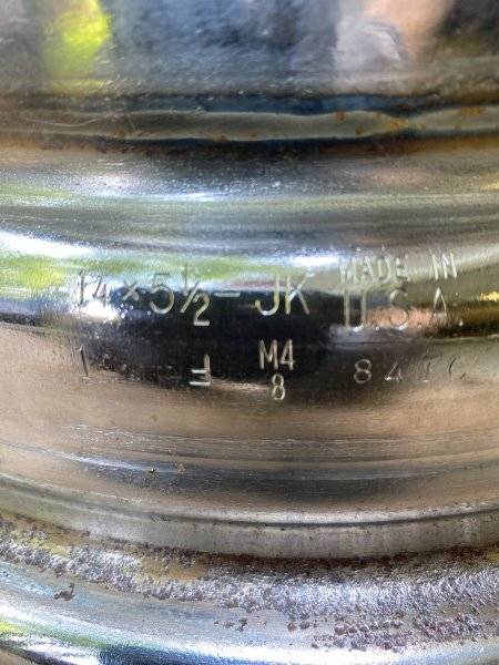

What date would this 14 x 5 1/2 JK chrome road wheel be?
Thanks for the help.
Hotrod20
M is motorwheel
4 is plant #4
8 is 1968
I'm thinking August 4, 1968. To the right of the M4 with the year under it, "8" the next two digits are 8 4 which I believe are Month and Day.
