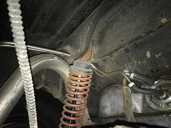

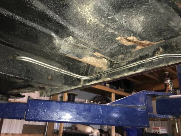

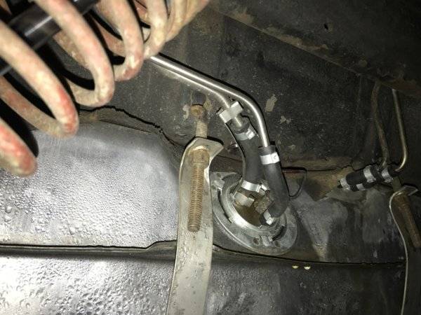

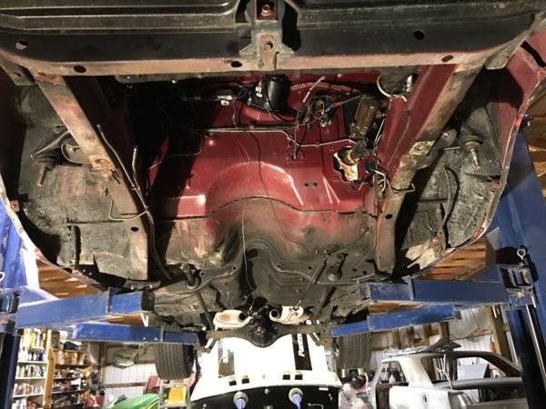

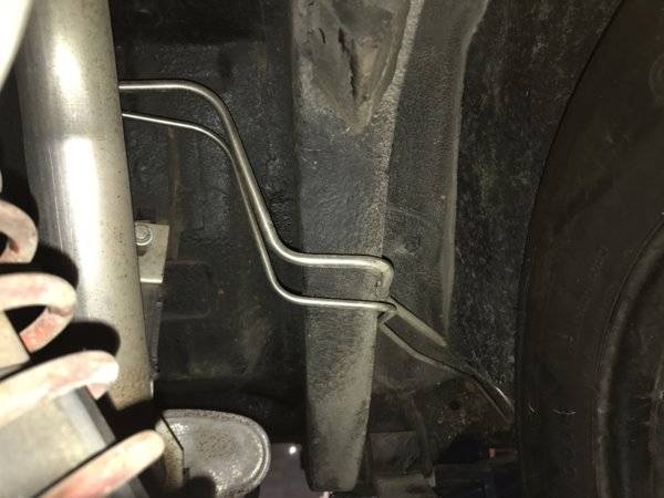

Hers a pic I had on the phone.
You can see the two lines come through the tortion bar crossmember.

The larger fuel supply metal tubing should to to about the shock tower and then continue via fuel hose to the fuel filter next to the fuel pump. The vapor return line leaves the filter via a smaller fuel hose to the metal tubing which extends 6-8 inches closer to the front than the main fuel line.
Don't mind the hillbilly helper springs. I haven't gone through the rear suspension yet.

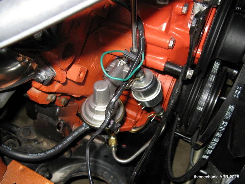

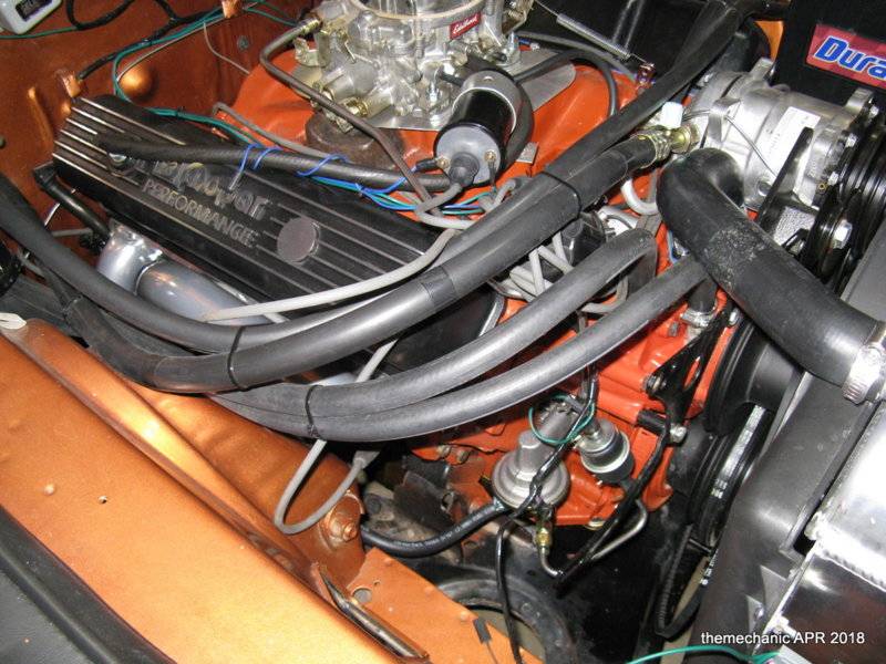

69 Charger RT, top is 1/4 rtn line, bottom is 5/16 fuel. From there, hose to filter return, and hose to fuel pump, respectively.

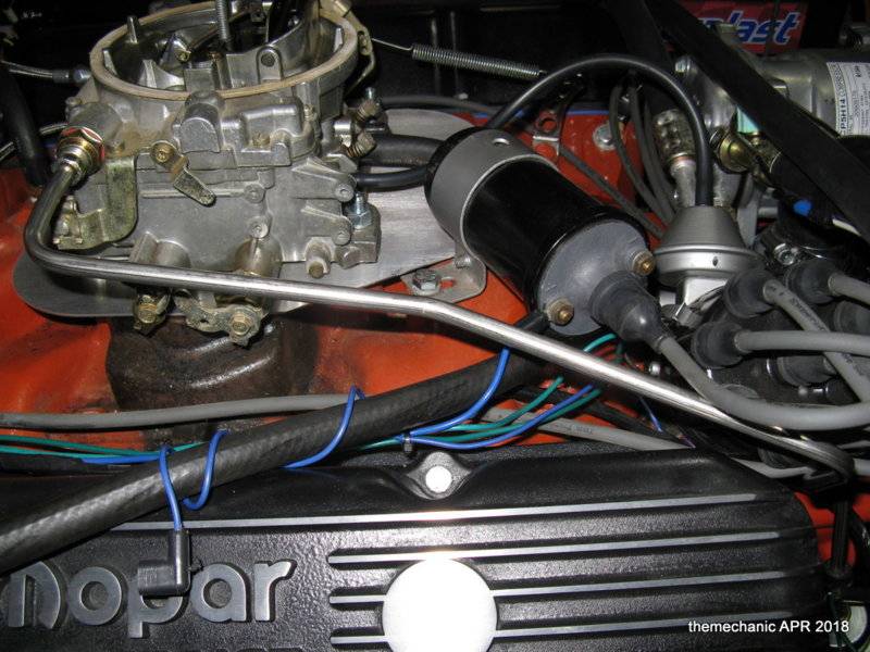

Back when I had an Edelbrock carb and stock fuel pump the rubber line from the frame rail connected to the fuel pump then a short piece of steel to the filter then long steel line to the Edlebrock carb.

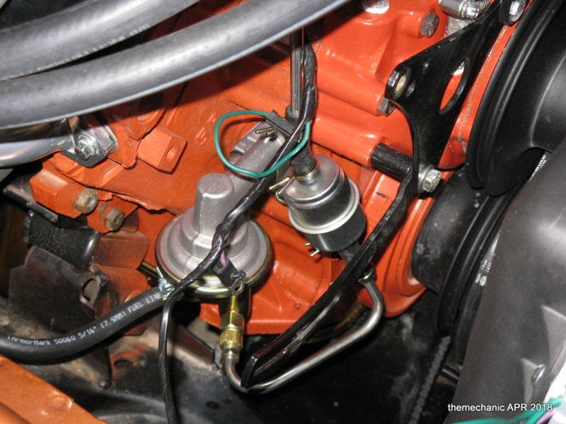

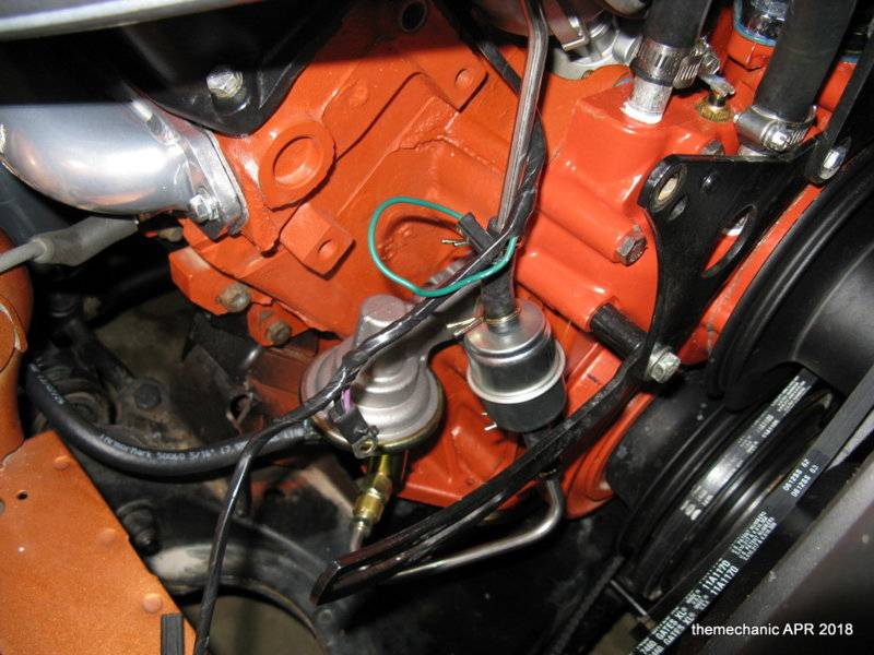

View attachment 591817 View attachment 591818 View attachment 591819 View attachment 591820 View attachment 591821
Hey now this is great!!! So this is something like what In-line tube just sent me. Only there is a Holly something or another on the care so I have to maybe do something different with the filter up on top of the motor. But what you have here is need to know info. Thanks a bunch.
By the way what pump is that you have there? Sounds personal don't it?

That's for an oem line from pump to an Edelbrock carb. I now have a fuel filter/vapor separator in place of that filetr then a rubber hose up to the Holley dual feed steel line.
