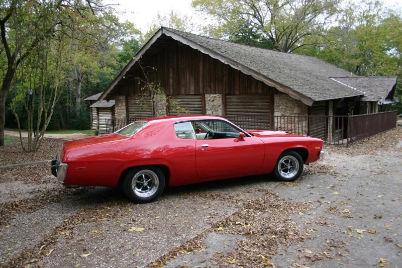

I am going to replace my old worn out leaf springs and wondering if anyone had advice on what would be best fit for my preferred ride height.I have a 73 Roadrunner with 16" Magnum 500 wheels and like a fairly low ride at the rear. I really don't want to have the rear sticking up but more of a even plane. The car has a 440 stroker (500CID) Dual Quad intake so traction is a priority and i figured new springs would help.I have searched several sites for HD or Stock but have only seen springs up 72 B Body, no 73. Any suggestions where i might find them and will it just be a plug and play or will i need hangers, U bolts etc? I want to be sure i get everything the first go around because i work overseas and only have a couple of weeks to cruise. I don't want to be waiting on parts when i am home. Any help would be appreciated.

Didn't know that could be done but will look into it if i can't find replacements. Thanks!
Had mine on The Golden Rotisserie Chicken Rearched . I had them add back in 2 inches of arch. Then I powder coated each leaf and reassembled them with new shims and plastics and new bushings. There on the car now and it looks like the ride height will be ok.
