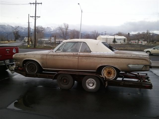

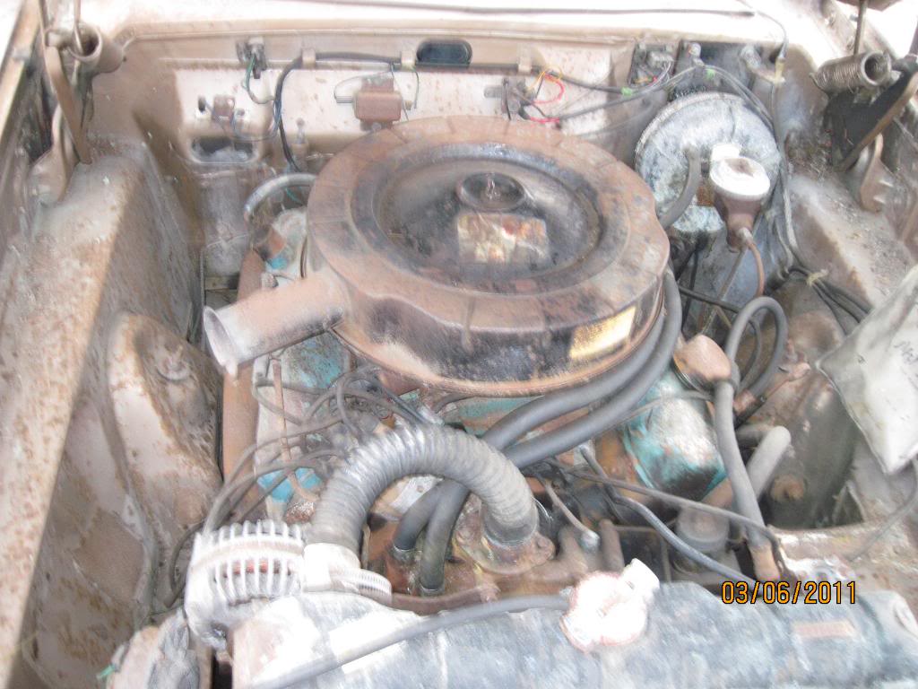

OK, I am going to build my original 383 for this 63 Polara vert. However I want to pep it up a bit. I would like to get 450 HP and make it very streetable. Its its original 63 383. I dont know the heads of this era and I am open to buying a set of Eddy heads or what ever it takes to make it right.
The car will have its power steering, power brakes and after market air.
I had planned on using my 500 (650 HP) stroker for this project but my engine builder says he thinks its not right for the street.Solid lifter motor and would not last long when cruising in it.
So I need to build a nice running 383. what have you folks done and what suggestions do you have on what to use from this engine and what to replace or upgrade.
