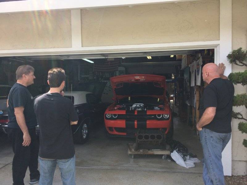

$400 for this 440 Core on the garage floor in front of the Hellcat. Not bored, 1974.
