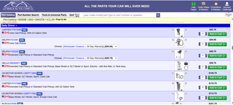

Guys, my Dad passed two years ago and I just got his 2002 four door Dakota V8 truck. Truck has been sitting at least 5 to 6 years and is full of rotten gas and fuel pump is bad, and needs replacing. Since so much China junk has flooded our country, I am wondering if any brand is 'better' than others. I have installed single Walbro pumps in the past , and had good results, but it looks like I will need a complete unit for this replacement and they don't list who's pump is in the unit. Im seeing units listing from $45 to $300 bucks.....geez....what y'all like, thanks....
RockAuto let's you select your manufacturer:

I got the cheapest one locally for my 2000 x-cab sport 4x4 and it makes noise the gas gauge read empty with 10 gallons left in the tank. But it pumps gas! Next time I'll spend more and get a better one.

Ive used Carter brand mechanical pumps with good results and how about Delphi, is that AC Delco brand.

I have had good luck with Delphi. They make pumps for many of the manufacturers.
Rock Auto ……
Get the best one they have & Use lots of
Lucas or Seafoam fuel treatments for several tanks of fuel …..
Seafoam helps lube the pumps & injectors .

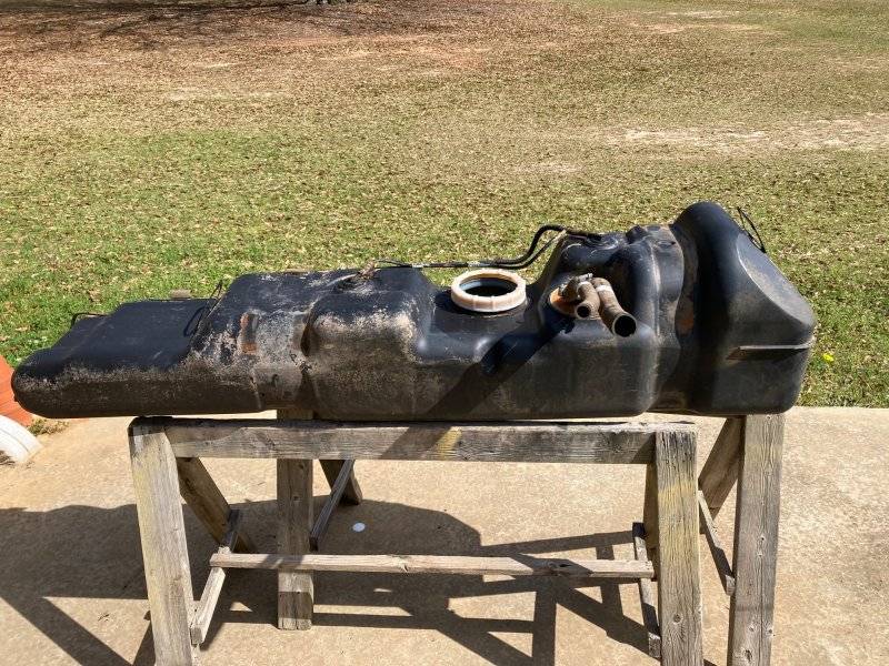

Removing the bed , or lifting it up, is of no use on this model. The four door cab goes way over where the fuel pump assembly is in the tank itself. I have dropped one end of the tank down and can get to the two, one large and one small, fuel filler hoses. They are about 20 inches long and no matter what small hose I poke in there, it hits something like a fuel screen right at where the hose and tank meets. Does the tank have one of those anti fuel theft screens in there? I may have to lift up the fuel pump assembly a few inches and get a siphoning hose in there to pump out old fuel.....Thanks all....

True but he's replacing the pump because it doesn't work. The Delphi or Carter will be just fine.

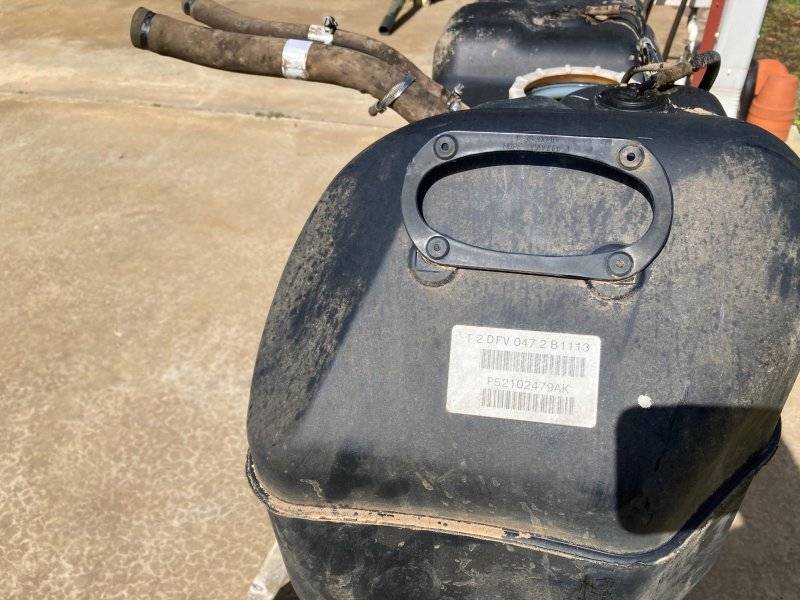

I got the tank out with much 'persuasion ' on my part. The two filler hoses attached at the tank does indeed have a screen inside and you cannot get a hose in there to siphon out fuel. Raised up the pump assembly a few inches and got a hose in there, pumped out over 15 gallons of stinky gas. Pulled out the pump and the pickup screen was mush, sitting in ethanol gas all those years will surly make rot rather quickly. But, with that big ole pump removed, it was easy to get my arm in there and clean out the plastic tank real clean. Now to order a pump, anyone know if this is the 22 or 24 gallon tank, seem there are different pumps.....
