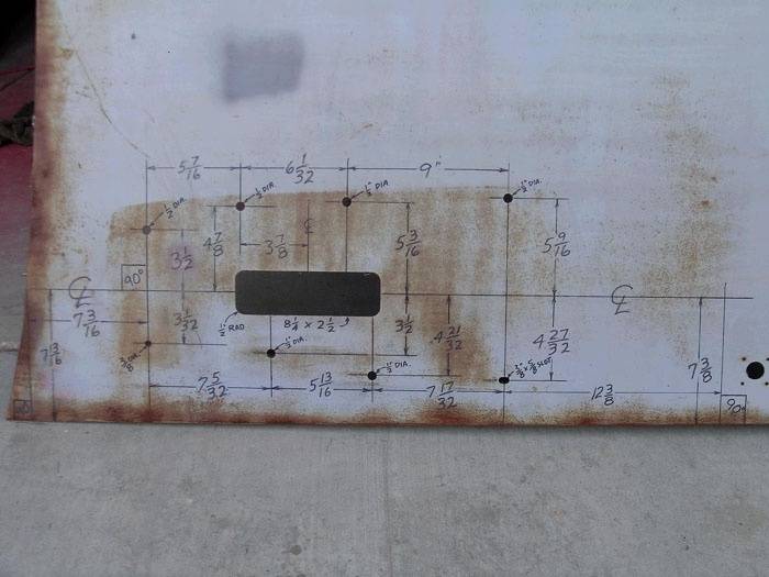

Here is a template Partsmix sells for $35. I have bought parts from them at good prices and fast shipping. I do not know anything about the template other than what is on their website. The Ramman has a template for $110 on ebay. The photo shows the hole size of 1/2". I bought my flat hood pre-cut and drilled and the hole size is 1/2".
http://www.partsmix.com/mopar-69-70...-twin-hood-scoops-mounting-location-template/
http://www.ebay.com/itm/RAMCHARGER-SCOOP-TEMPLATES-PUT-SCOOPS-ON-STANDARD-HOOD-/390878605341
Picture found.
http://www.forbbodiesonly.com/moparforum/threads/69-ramcharger-hood-scoop-placement.17183/

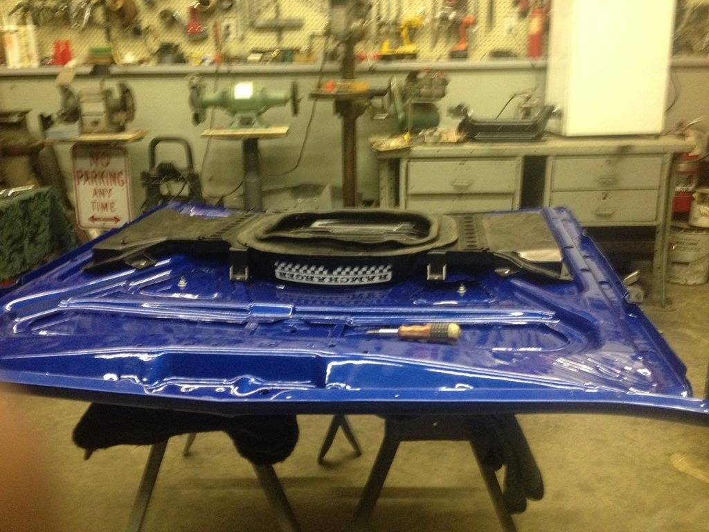

Does the molding on the front of the hood get painted before screwing it to the hood? The one that's on the power bulge hood on the car now looks like it was screwed on then painted.
we painted it all before putting it on the hood and the hood was painted the color of the rest of the car before we put on the hood .
