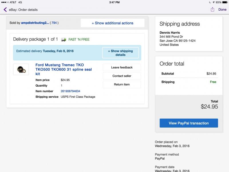

AMP through ebag. Hope this is it. Local parts house cannot cross reference part number.
