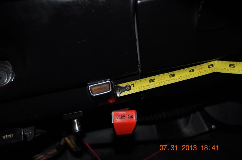

I just purchased the last piece I needed to properly change my Bee to a 4 speed trans to make it look like it came that way originally. The amber reverse light in a chrome housing that mounts on the lower dash area. I know they came on 4 speed cars from the late 60s to the early 70s. But I would like to know if anyone can help me on where it should be placed at? Any help is appreciated.
Hope this helps! 69 Roadrunner not Bee. Don't know if that makes a difference or not.
Measure out that location in the picture above, and you should find a cut-out on the steel dash frame inside. This will give you the spot to put the reverse light. All cars I have seen had provision for the light.

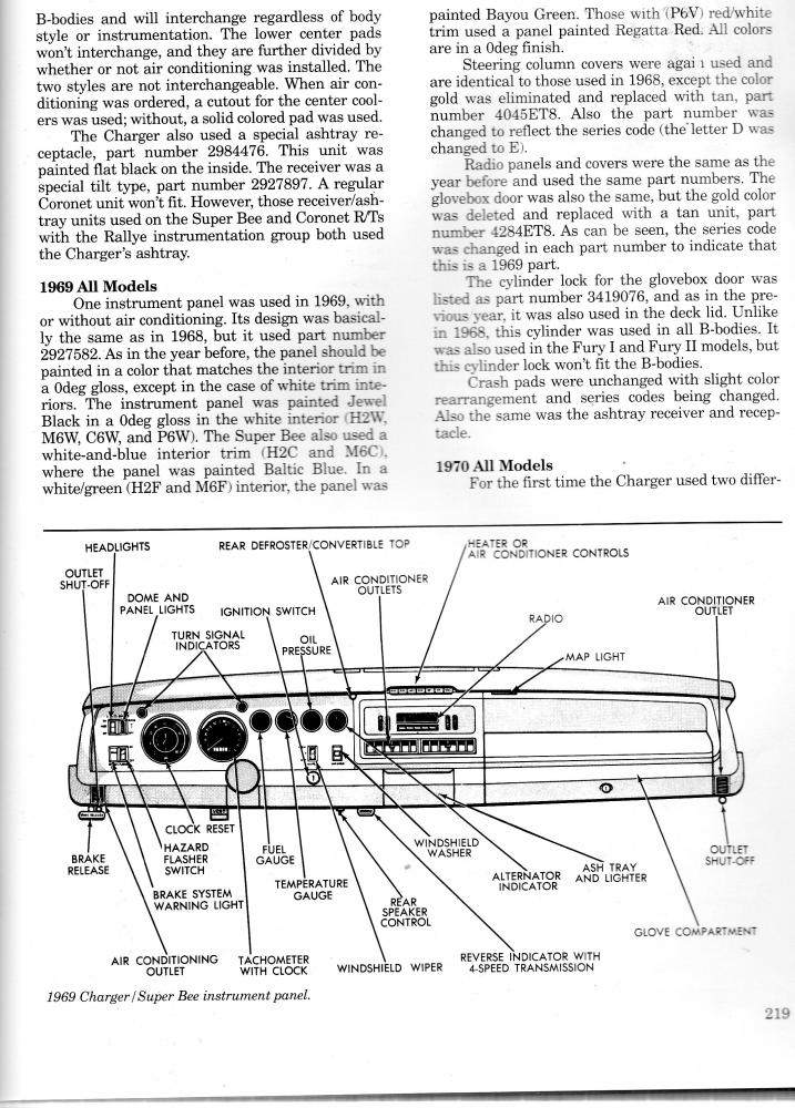

I have a scan from the service manual that shows the dash. I can post it tonight.
4 speed reverse light
Here is a scan of the dash for the 4 speed reverse light.
