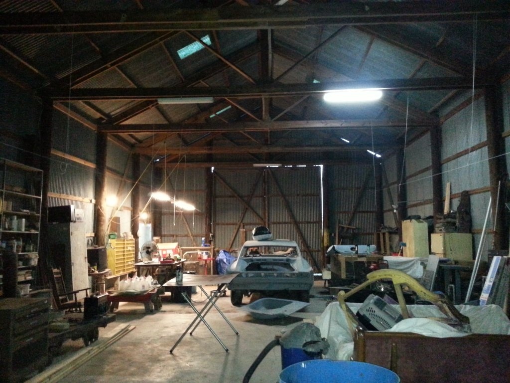

Here's the shop. It belongs to my wife's grandmother and she told me I could use it (rent free, no bills) after her son died. Problem was, it literally took me a year to get it this clean and clear. It was a maze to get through, but I got it this far. It's 30x60 feet. Plenty of space, but lighting sucks. I bought some fluorescent lights, but the roof is high plus the bulbs have burned out in a year. I don't want to put a lot of money into the lights because when she passes (she's 95 now) the rest of the family will swoop in and either sell it or sell everything around me and I'm out of here. Any thoughts? And thanks for all the thoughts
White. If you can, paint the walls/ceiling all white. So, whatever you do for lighting, it will increase effectiveness.
Portable halogens or buy a few of the 4' LED lights and Sams Club. They install fast and aren't that expensive, relatively. When it comes time to move out you'll grab them and go.
The cheapest to buy and the easiest to take with you in a hurry are the 8' florescent. Hang them on chains down where they can do some good. Get the cold start, single pin ones. I see you already have some. The don't use much electric either.
I'm not familiar with the 4'leds, so I'll check them out. I put the florescents up, but I should have lowered them. they will require a little work to remove them though wiring wise. white sounds like a good idea. I've thought about painting, but it's always been down the road.

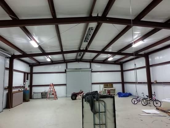

We built a 30x60 a couple of years ago its 14' at the walls. I installed 6 of the t-5 fluorescent and they are awesome...not real cheap but economical to operate. Most big box stores carry them now..
Just space equally and hang from the bottom of the rafters as not to get shadows.
Mike67 's is a great example of economical, efficient lighting, along with white walls & ceilings. The white reflects & diffuses the light all around, creating a brighter environment.
Thanks everyone. sounds like I just need a few more lights and lower all of them. Then paint the inside. The shop was used for farm equipment when they grew cotton here, so the ceiling is high

Found a pic of the shop right after I installed the lights
Cool I can see my estimate of 4 looks about right. How many bulbs per fixture are you using? We've got 2, 4 and 6 bulb fixtures at work, 6 bulbs is like a tanning bed!
