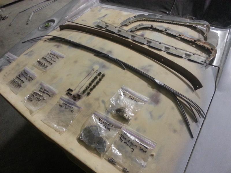

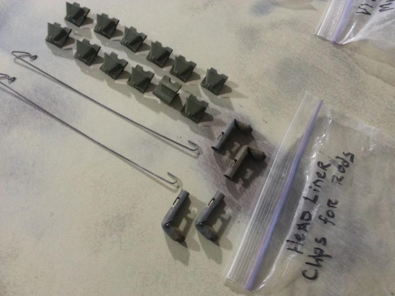

I still have a couple questions though (sorry! Haha), I dug through all the hardware that came with my car and it looks like I've got everything but the front windshield interior trim clips, but I'll get to that later.
All the bows, bow clips and both listing wires accounted for. Is there supposed to be some kind of clips over the rearmost bow for the listing wires to hook to or do they just hook over the bow itself?

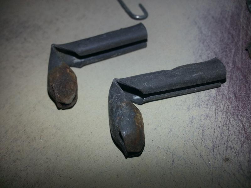

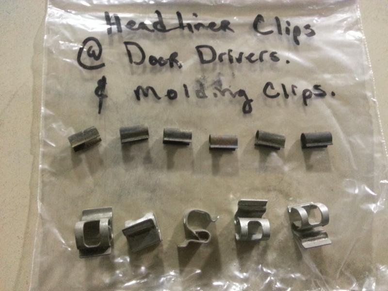

And I'm not sure where these side clips go ? (headliner and all trim/hardware were removed and bagged as you see it when I bought the car) I would guess they clip the headliner to the body under the drip rail somewhere? Maybe the tube-like ones are the ones you mentioned in your post Airgrabber?

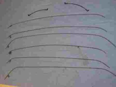

Basically the only other things I'm not clear on are:
1) how the short bows go in, and where exactly.(?)

Hi Speedy,
The two x hooks just go over the rear bows.
The small clips simply crimp the edges of the headliner material over the edge of the roof steel - random spacing to suit
The larger "S" hooks are ysed to secure the side rail inner cover trim - profile like an "L" - again at random spacing, and it looks like you are least one short - 3 each side minimum.
Also, I'm not sure where you plan to put those sparkplug wire terminals....probably in the engine bay would be best :(
My best advise is for you to post lots of detailed pictures on how you do it so when the time comes I'll know how lol.
Also I think either northerndave or propwash posted how they installed their headliner and was specific on how to do the sail panels. Hope this helps.

Thanks kiwi! By x hooks do you mean just the "zig-zagged" end of the listing wires?
And no problem with the side clips, I have another bag with the same clips for the passenger side.
And are you talking about the four pieces under the listing wires in that 2nd pic? I thought they were the clips that attach at each end of the short bows??
Someone else's pic from DC.com:
