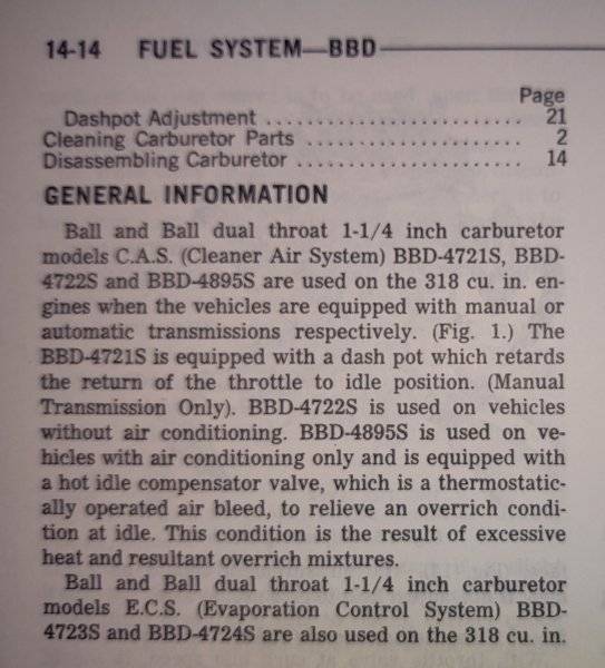

I always called it a Ball and Ball Dual too, but figured I had better double-check my memory.
Checked my FSM...
