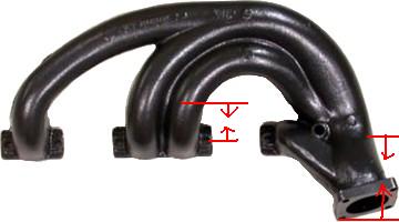

Wondering if somebody could give me some measurements or point me to some info on max wedge exhaust manifolds? I need measurements from the last exhaust port down to the bottom of the four bolt flange. I also need the distance from the center of the head flange to the outside of the exhaust tube. and the how far off the block the edge of the four bolt flange is. Heres a crappy drawing to help.. lol

I am trying to see if these will fit on my barracuda flip flopped right to left and pointing forwards for my turbo set up. need to check K member and steering gear and paaenger side frame rail.
Hard to measure on the car,mine are in a 62 B-body.This may not be perfect but real close.
Exhaust port to bottom of flange. 5"
Head to outside tube,4 1/2"
Block to outside of flange,6"
