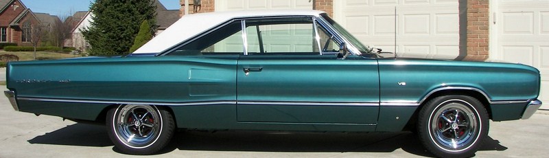

Post a pic?
I grew up in Ohio from 69-87 and had a K1 med turqoise 67 white hat special, which I drove fully loaded (I mean FULLY) to FL.

Not mine (wish it was this nice), but this color-
i bet its still a beautiful car, i know mine started out life orange, but it wears its new black paint well. and thanks for those links, i appriciate the help
