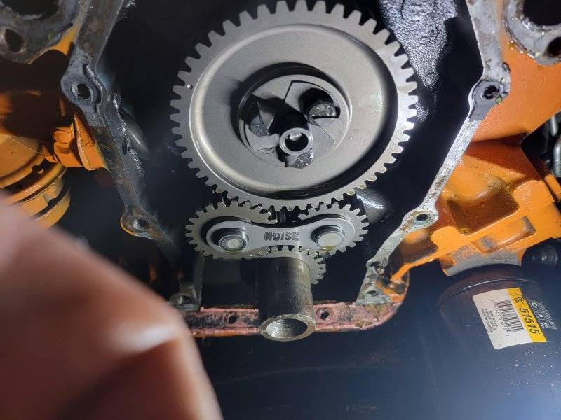

I am replacing this gear drive with a chain.

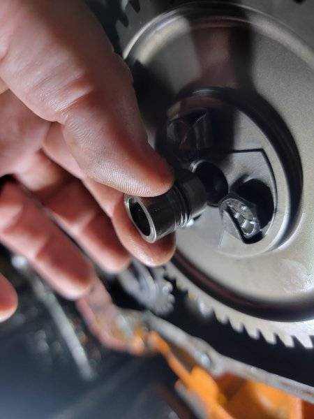

When I install the chain do I need to use the little bearing looking thing I'm holding in the picture? And I did not see an oil slinger plate behind the crank seal. Do I need to get one or can I reassemble it without?
If it's a roller cam, it's required. Flat tappet ,not necessary.
Many people have run without a slinger . Put a new seal in.
Oh yea,
Can I reuse that bolt lock plate or should I just use some blue Loctite?
I would put an oil slinger in. For the $10 or whatever they cost, it helps keep oil off the front seal.
It's one of those things that is so easy to do while it's all apart, you should do it.
I vaguely remember when Chrysler went to the double lip front seal they discontinued the slinger. Early 70s.
Mike
I recall the slingers were still used at least thru '72 even with the double lip seals. I'd use one. I used the roller cam button on my drag motors for years. But I measured the cam movement to be sure where things were. IIRC I was looking for less than .005 thrust with either the flat tappet or roller cams. I would also check the timing cover for any wear.
