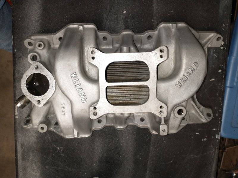

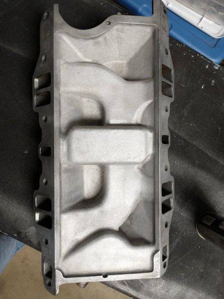

I used Gunk Degreaser followed with Superior Products Aluminum Brightener and a SS wire brush. I used penetrating oil, a 1/2" drive breaker bar and a 3' cheater pipe to loosen the pipe plug. I tried heating and tapping the plumbers fitting some idiot used for a water line connection but it's stuck.
Here's the results.
I searched but didn't find.
So far, I've degreased with Gunk original. It still has carbon inside the runners and oxidation on the top and bottom outer surfaces.
I'm thinking about using NAPA Aluminum Brightener. It works well on sill plates.
What's your method for degreasing and removing the oxidation?
Thanks in advance.
