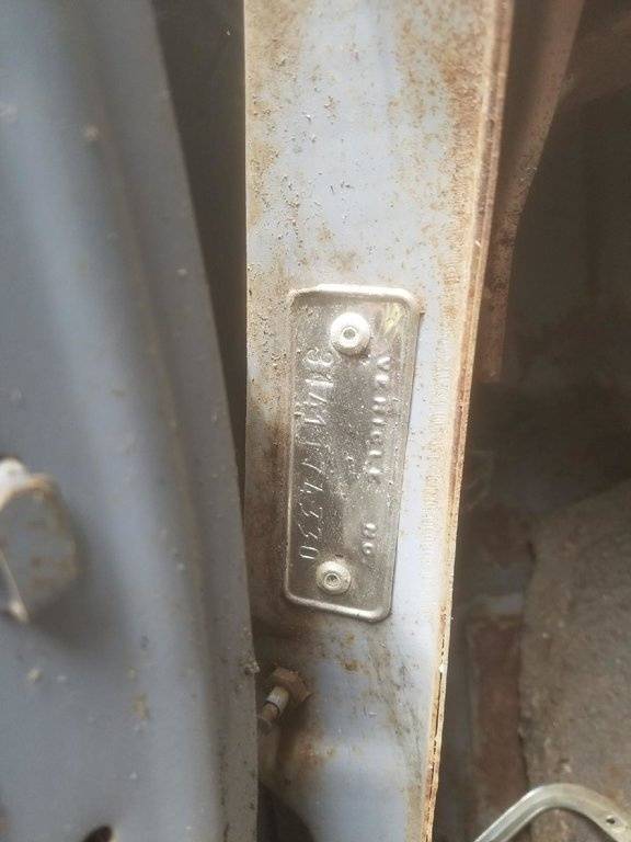

as a side note. those rivets on that vin plate are not original. they are spot welded on early b-bodies not riveted to the best of my knowledge.
YYou might want to look into this further because I have two early Chrysler cars and there both rriveted in place not welded ! On is a survivor car the other has been owned for the entire life of the car by the same owner !
Ones a Plymouth ones a Chrysler

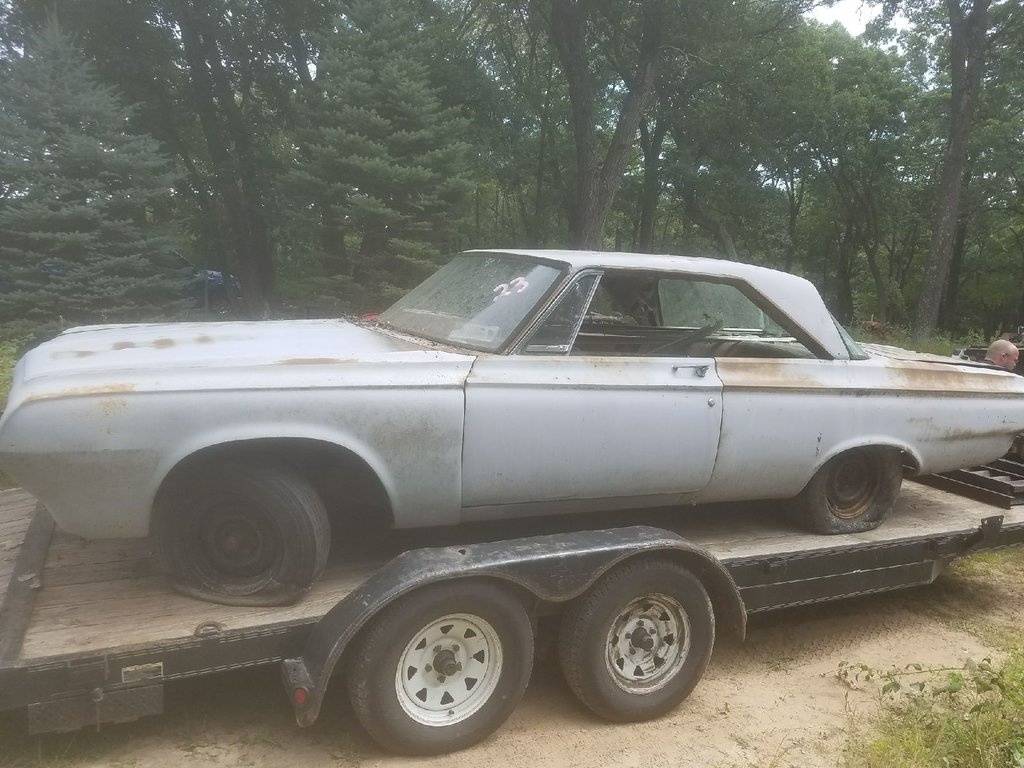

Ok, so this is what I have found online, and with the help of you guy's so far. I am fairly confident that this is a gold 64 sport fury Max Wedge 4 speed car. Does anyone have the Darrel Davis book for 64 that could help me out checking the VIN number? This is the original color of the car in the picture.
Jeff
Alrighty, got it figured out now, car is a 64 sport fury 426 street wedge, console 4 speed car, with 3:23 rear gears, it's in the garage, pics will follow as we begin the restoration.
hope you got all the side trim with it looks like they filled the holes for the trim good score
