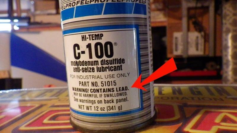

Oh YEAH!
The good stuff.................
You always use a thread dressing when bolting to aluminum.
But when its steel/iron I like the copper anti-sieze, has a 1800 deg rating...
