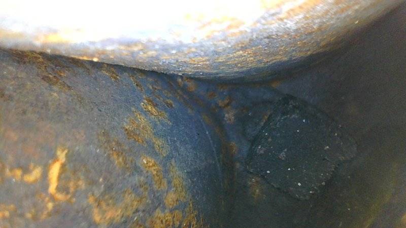

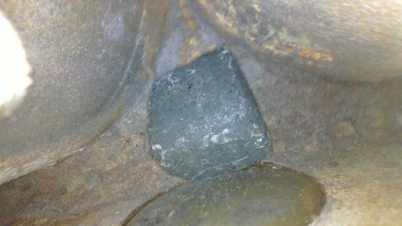

Now I'm stumped...did pressure tests in each hole. No problem there so no blown head gasket. Ran a scope in the holes looking for a Crack or something. All look OK.

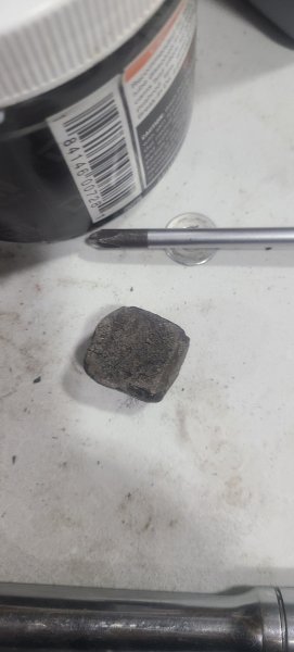

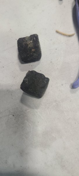

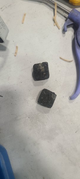

Then I remembered something during the build. While I was working in the block, I noticed something like a loose bolt in the block. Turned out it was a piece of casting on both coolant banks. I had to remove both frost plugs to get them out. Both in the same location on ea side.
My builder machinist told me that's common on old blocks that were cleaned. It's old rust and crude build up and then just let go. You'll be fine. Finish the build.
Well now I'm not too sure....here are the pics of what I found....any thoughts or same experience?
Maybe try pressuring up the coolant system and see where it's joining the oil system??
Yuup...that was next plan. As the intake is off I'll make 4 plates to cover the coolant passages. Then plug the water pump outlet and large return. Just leaves the heater inlet to run some pressure.
I found these in the center of ea side. Removed frost plugs to remove as was too large with a grabber...think they came from somewhere?

With a .060 over bore and a piece of cast in the coolant rail means rust got cleaned out when it was cleaned and it had enough rust to blow a hole between the 2.
