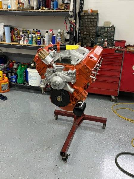

My car came with a 383 like most others but decided to go with a 440 my friend Cliff Lowrance had on an engine stand (he has a 68 Roadrunner with a Ray Barton 426 Hemi going in it). So I bought the 440 from him and he has completely rebuilt it. Came out of a 69 Charger R/T. Will be going in soon! I'm pretty stoked about it.
Looks great, do you have the specs on the build?
+30. Heads are 64cc. Mostly stock but has a decent lift cam. 10.5-1 compression. Not sure on the hp but over 400 I'm sure. New oil pump, billet distributor, fuel pump, trw pistons, water pump and new housing. New 6 qt oil pan.
