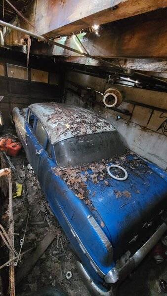

my grandfathers car.. same deal... one owner... dont know where to post...same conditionView attachment 1229754

Tell me more about your grandfathers car, looks like a 56ish Pontiac.

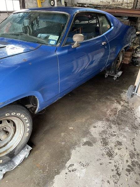

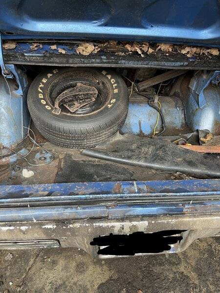

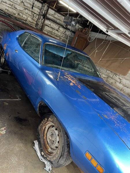

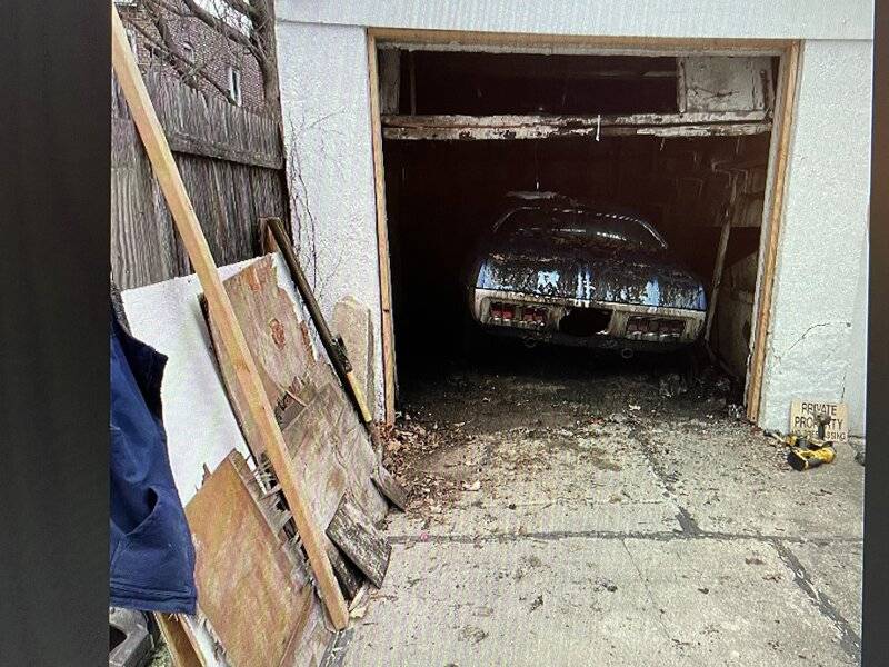

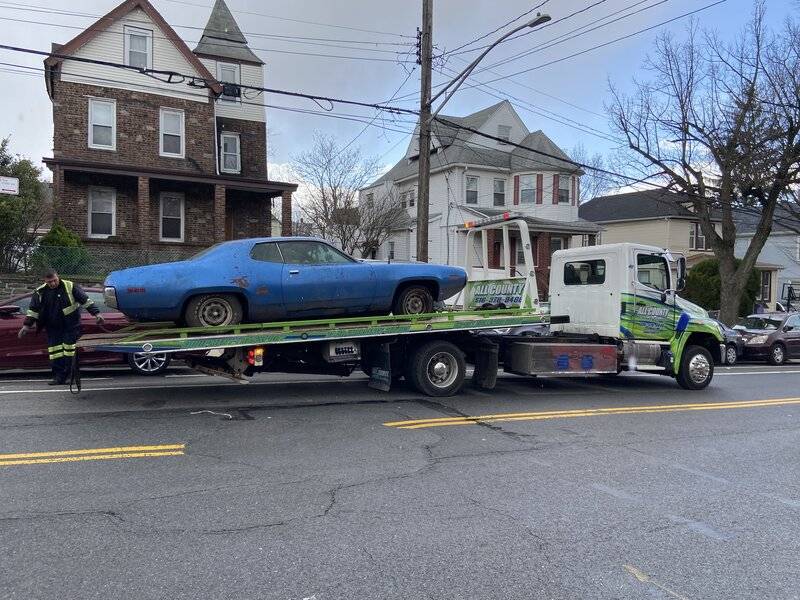

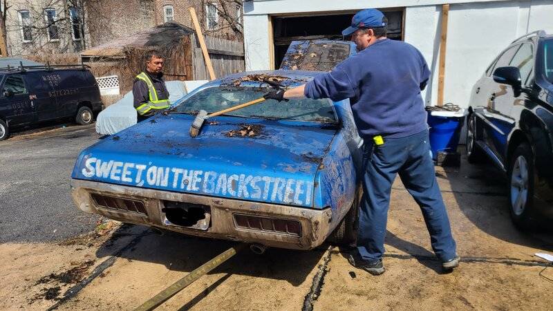

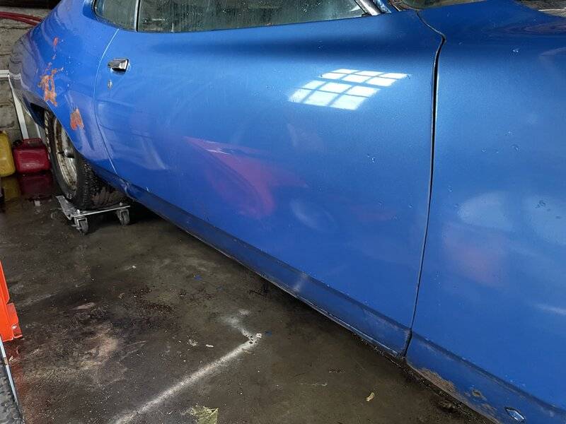

here is the reveal, and removal to a better home. lucky for me no racoons. The phrase was words he left for me after i challenged him to a race...it didn't go well for me lol. but anyway its washed and moved to a drier location now.
sorry for all the repeats of the photo, still learning on how to post

Wow, that’s great to see you got the car out, cleaned up and moved to a safer home.
What are your long term plans now? Are you going to get her road ready again and relive your youth of running the streets in Dads Hemi Road Runner?

Welcome to a great group of gearheads. It may not look it, but your father left you a valuable gem that just needs a polish. Wash and buff, don’t repaint it. Your father only put 11,000 miles on a 50+ year old car, that’s a gift. Put a battery in it, see if it turns over, don’t start it, check the lights, radio and accessories. Turn to your fellow FBBO’rs for any and all support.

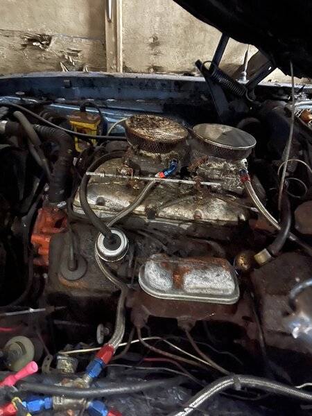

NICE!! Definately DO NOT START IT, at least from tank's fuel!! Marvel oil EACH cylinder, let soak, hand rotate, change oil & fuel pump, prime oil system, then "FIRE IN DA HOLE" AS YOU VIDEO IT for the FBBO "NUTS" ON DIS HERE SITE!!
Forgot: Make a toast to pop when its running!!
Yes turn it gently by wrench, if it stops don't force it!!!!!!
But really it should be boroscoped first. Cylinders, lifter valley , under valve covers etc.
You could wreck the original motor in 10 seconds flat.
