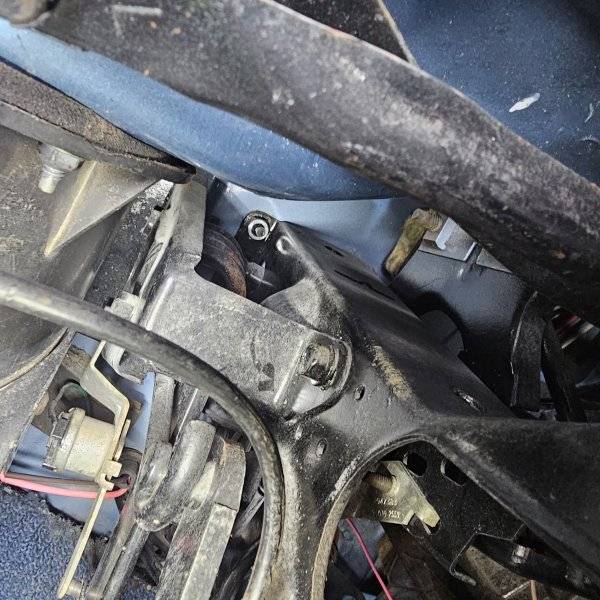

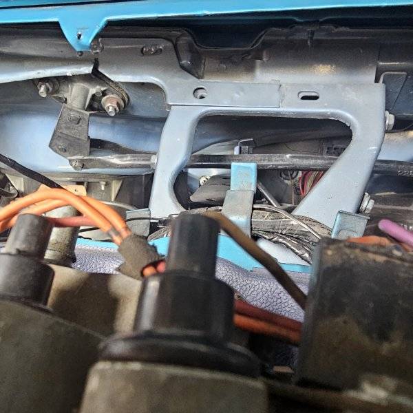

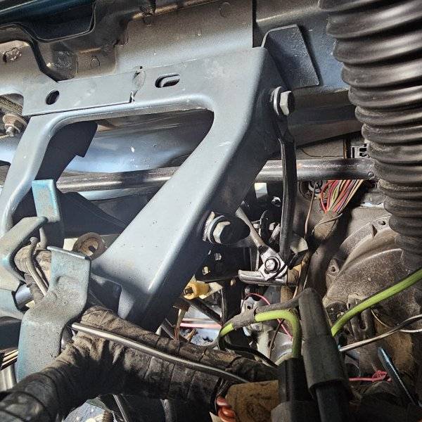

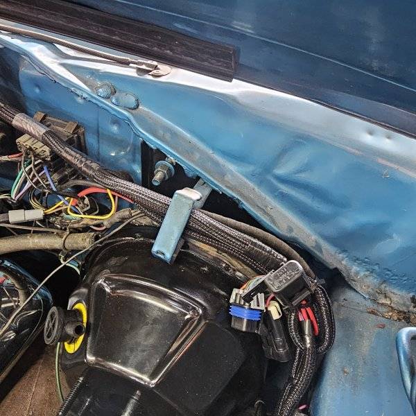

Pics are of the upper nuts that are accessed with cluster out.
