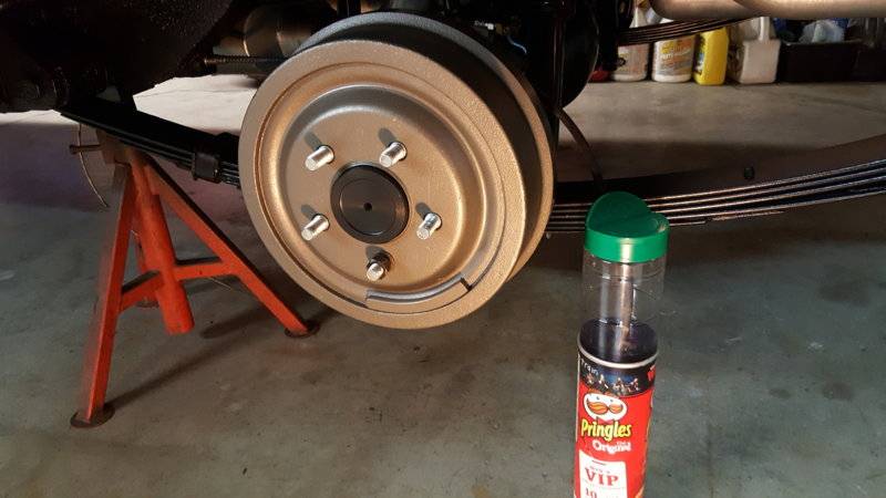

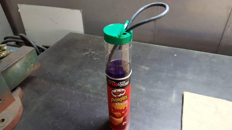

Get a helper and do it old school. The gravity bleeding might not be getting all the air out.
No helper? Do it my way. Keep the end of the hose in fluid. Break the bleeder loose, push the pedal to the floor once, tighten the bleeded.
Right rear
Left rear
Right front
Left front
