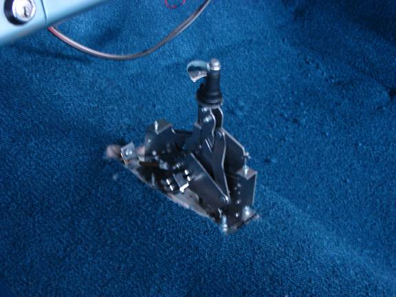

There was a cutout for the shifter (Satellite, I presume) and when I laid this out the cutout was in the exact spot that I bolted my B&M Shifter...

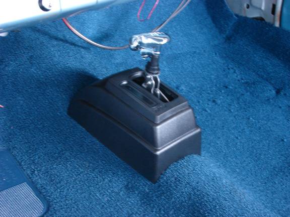

With the shifter cover trimmed and installed...

Oh, and there wasn't a hole in the carpet for the shifter, just a cutout in the jute padding... but it was in the exact spot I needed it.

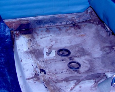

Question since your seats are out. I didn't have interior to start with so is there hardware holding the back bench, top and bottom, in the car? Or are they forced (snapped) into place with the springs on the under side? My interior is still in a box from the Phoenix desert. Thanks.
Thanks. The bottom seat portion is just hooked in at the floor, and the backrest is hooked at the top, no hardware, just lift upward. I think you have to remove the rear armrests in order to get the seat out, you have to angle it forward to remove it.

Sweet, was hoping I wasn't missing any parts.
