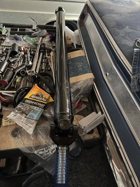

Hi;
I need to have a new driveshaft made for my 66 Coronet; small block, 4 speed, 8 3/4" rear. From what I have been reading/seeing Mopar basically has two choices for universal joints; the 1350 and the 7290. They look to be almost the same size... The question is what is the difference between the two, beyond the obvious measurements, and more importantly if I'm have this driveshaft build which should I use?

I think I have this figured out finally. From what I have read, Mopars, at least vintage ones, use "inside locking" universals. These come in basically two flavors; the "Small Dodge" 7260 and the "Big Dodge" 7290. The 7290 was common in vintage big block 4 speed applications.
What I have going on is a 7260 transmission yoke, a drive shaft tube of unknown origin with a 7290 differential yoke. There is a "conversion" bearing at the differential end; 7260/7290. The shaft does not seem to be compatible with the bearings.
I'm going to have the new driveshaft built using 7290's only. I ordered a 29/30 spline 7290 transmission yoke from Dr. Diff yesterday. It was less than $100 including shipping. Nota a bad deal...

the 7290 and 1350 are almost the same in size. Given the choice, the 1350 is way more common, and can be bought cross drilled or solid. I also like the way the diff yoke U-joint straps bolt through the 1350 style yoke. If you break a strap on the Mopar type yokes and the bolt head snaps off, it can be a chore to get the rest of the broken bolt out of the yoke.
7290 and 1330 are the same size generally speaking- the cross is the same and interchangeable between the two with the correct caps and needle bearings.
1350 is larger and stronger than the 7290.
1330 is common on 67 big block cars with auto transmissions.
Unless you are making a bunch of power, you don’t need the 1350. If the 8 3/4 yoke is either the 7290, or 1330, I would just use that in both locations
I have a factory 340 4 speed car that has the 7290 universals fitted with the 8.75 rear end.
As posted earlier I agree - unless you are going to torture the hell out of it the 7290 will be more than adequate for the job.
Hi, Yes, the front slip yoke is 7260 but the rear is 7290. When I bought the new 3rd member Dr. Diff supplied a "conversion" bearing.
IMO, putting the 7290 on all four attaching points makes sense. But obviously, you’ll need to get a new slip yoke for the transmission.
