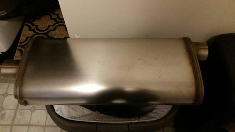

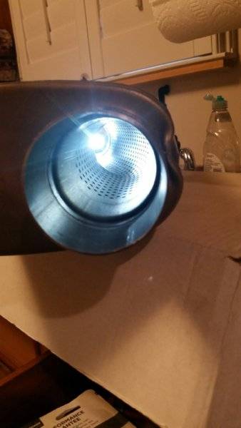

Accurate Exhaust, Roseberg ,Oregon heard good reviews about them
Muffler and tailpipe from accurate, mufflers were kinda quiet, but now the packing is getting carbonated and sound is getting louder good quality stuff ^
